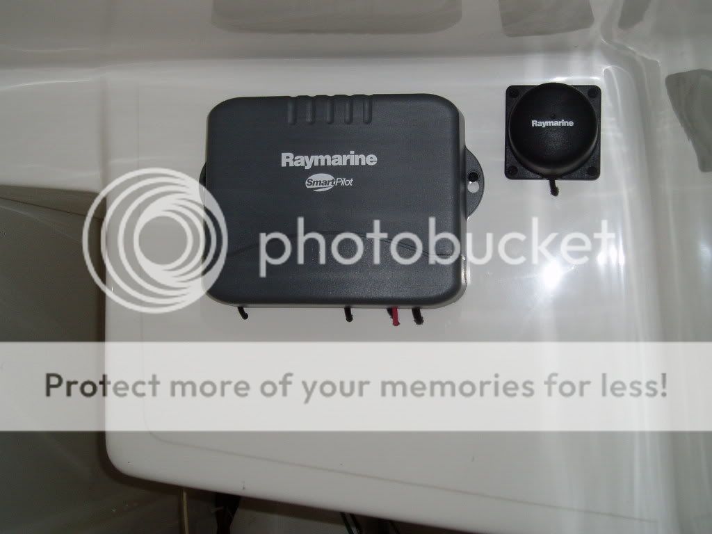

On edit: I'll read the rest of your post now and add, Here is my "Brains" install. The Controller and the Rate Gyro are mounted on the forward side of the starboard cockpit bench seat. These look directly at the rear head wall.
http://i344.photobucket.com/albums/p359 ... 260003.jpg
