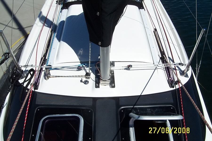

Bubba
here you can see my Cunningham at the base of the back side of the mast attached to the mainsail at an eyelet approx 9-12" up from the tack its the red line
their cheap to make its basicaly a small vang here in this pic you can see the red control line comes inside the dodger sitting on top of the sliding hatch

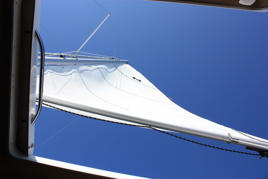

Okay Here is a picture of Museclehead sail in action. I had to lay on the floor of the cabin and shoot up through the hatch for the picture. "Otto Whihelm" vas steering das boot. Bubba I may be starting new job Thursday the 30th which gives me Monday available to get together for test sail otherwise maybe next week end. Does this look flat enough for up wind sailing? Sorry but it looks like a slight bubble near the middle draft stripe, but that could be explained since the boat was on Autohelm while I was taking pictures.

Re: Buying a new main sail ? Muslehead ?
The draft stripes show the picture. Looks drafty, though maybe your outhaul wasn't cranked down. Maybe mast rotation too. For sailing upwind in medium to heavy air, I don't rotate the mast. I know this can bring up a lot of debate, but I feel that mast rotation creates excess draft which counteracts the benefit of rotation. I only rotate to power up the sail. When I'm in depower mode, the mast gets centered and pinned, cunningham tight, outhaul tight, backstay tight, vang tight and traveler to leeward.
