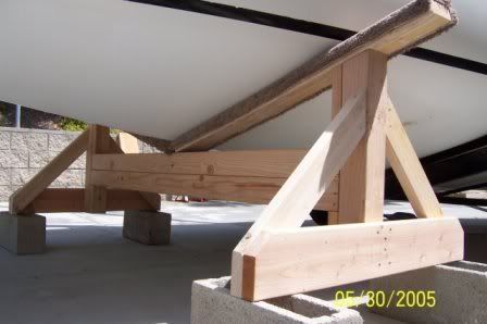

Corsair, when you see boats resting on stands they were set on them, likely after the boat was lifted with slings. Sum and myself have made craddles for the stern, Sum's design much better than mine. I suggest you take a look at his pic's. If you put the stern in the craddle, you can simply rest the front of the boat on a single point under the keel, maybe some large blocks of wood, or a stack of wood. Just in front of the pivot point for the swing centerboard, is a good place to do that. Maybe in your pole barn you can rig sligs to help with this process. Sounds like a perfect place to work!
Considering the state of your hull, I'd be real careful! Try to analyze the situation the best you can before applying pressure to the hull in other spots, you don't want to make it worse. For that reason I don't like the jack stands idea, I'd use a craddle, where good solid pressure is at the keel.
http://s33.photobucket.com/albums/d64/d ... s/Craddle/

VERY HELPFUL PICS! I went to your other pics and was greatly helped. I think that I will build a similar cradle to yours for the stern - and then use a sling on the front so that I can remove the trailer without having to constantly remove the jacks and blocks on the front. Once the trailer is out of the way, I will then block the front or perhaps even make a front cradle for more stability, depending on how much more work I might do in that position. After I get it off the trailer, then I'll be back with questions that are trailer-specific.If you put the stern in the craddle, you can simply rest the front of the boat on a single point under the keel, maybe some large blocks of wood, or a stack of wood. Just in front of the pivot point for the swing centerboard, is a good place to do that. Maybe in your pole barn you can rig sligs to help with this process.

Doug's support looks great to me.
Here is mine, with the orginal in the background, and a second one in the foreground. ....
...I've had the boat off the trailer while working on the trailer adding the second axle. I made the second one as I didn't want the boat only sitting on the back one for an extended period. So I used the back one at the back and the other one further forward and then had the boat blocked under the keel a couple places forward.
I made a support for a sling......
......also and attached it to the wall (right arrow in next picture) so that it couldn't teeter fore or aft. I made it out of some 2 X 8's I had left over from building the house.
The bracket (middle arrow ) comes off when taking the boat in and out of the shop and on or off the trailer. Then the bracket goes on when the trailer is gone. It and one like it on the other side go up against the bottom of one of the side stanchions on the boat where the cutouts are (left arrow) and just give me a better feeling that the boat won't move side to side or tip. I've set this up for permanent winter storage, so I can get the trailer outside and make it easier to get around the boat. I only use the sling while pulling the boat off the trailer andhave the boat on the back support then. I also pull the wheel/tires off at that point to make it easier to pull the trailer out.
Here is a picture of the left support that shows how it is attached at the top (arrow) to the door track to keep it vertical.
http://purplesagetradingpost.com/sumner ... upport.jpg
See next post of mine about the trailer mods,
