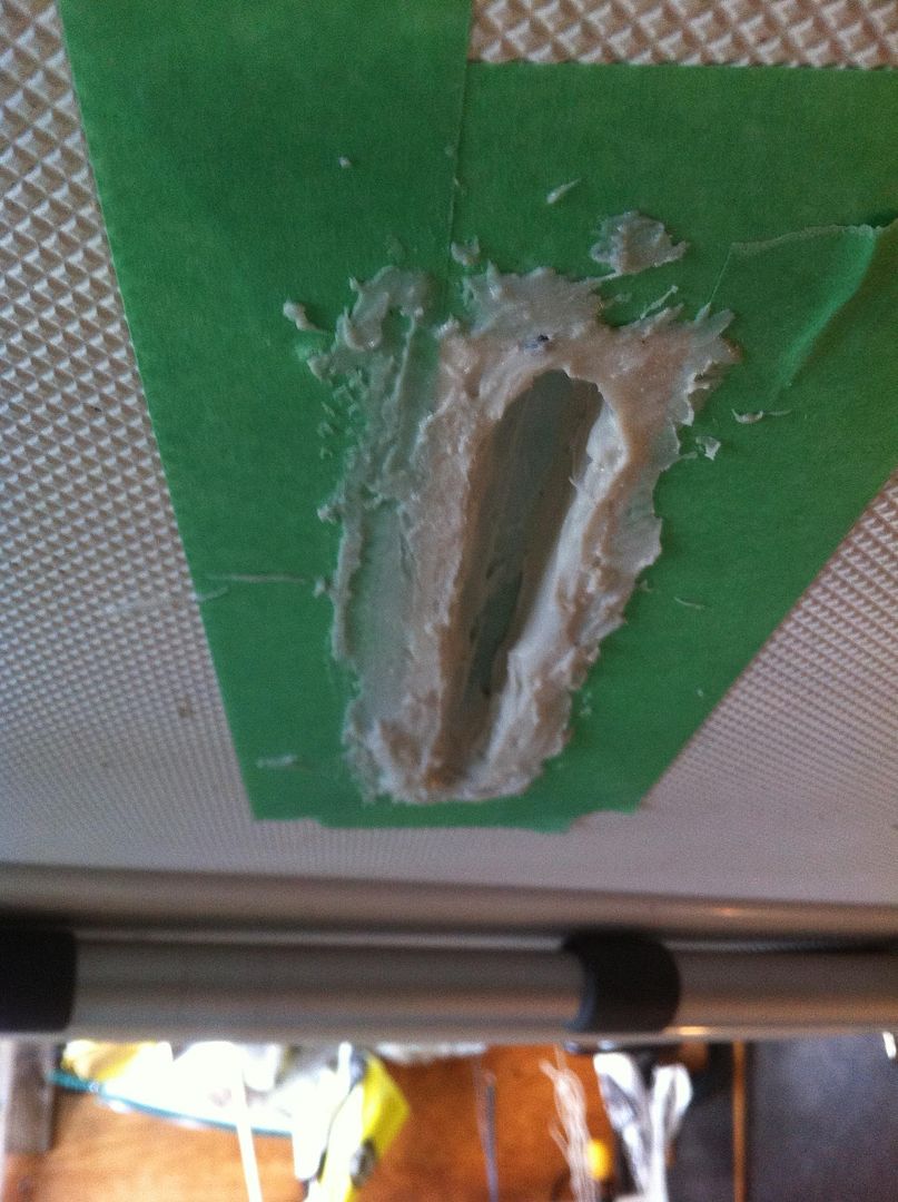

well she is all done now with new anchor rode containing 50' 1/4" G-4 Chain & 200' X 1/2" rode , just to finish up the slot in the anchor hatch with epoxy finish it done just have to clean it up to look clean & professional

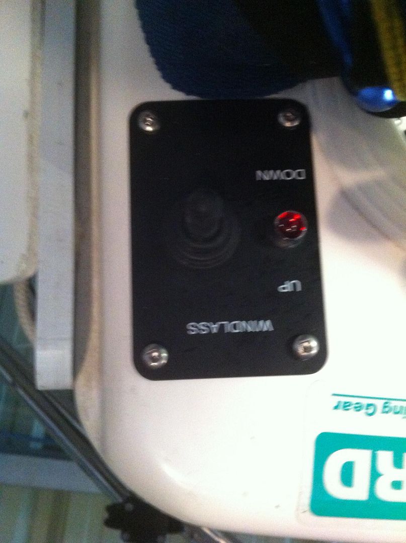

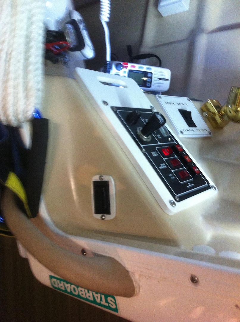

the cockpit windlass switch I mounted here on the S/B side entry , this required over 30' of 18G X 3 wire from windlass to reversing relay then back to cockpit control

just below that switch I also installed an off/on safety switch I will post a pic of that later when its labeled , I changed his single bezel & switch out & made a new double bezel with new lighted cockpit switches one for the spreader lights & the other a safety switch for the windlass
