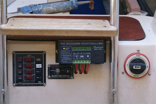

For the last three months our two permanent boat batteries have been kept charged by a small 10"X 8" panel which plugs into an Anderson plug on the arch that our normal working panels (130w) sit on, but at anytime I can check the state of charge etc and it keeps the batteries at full charge, this is essential to a long battery life.
http://www.ebay.com.au/itm/SOLAR-REGULA ... 53e6adabee
This is not the same brand but exactly the same unit, the only problem is the lcd starts to break down after about two years but they still work perfectly, I have had three over many years, they make conserving and knowing what your battery is doing so easy.
I use it only for charging, the protected supply circuit is not used but in the photo it was to control the pumps, the two cables on the left are now not connected.
