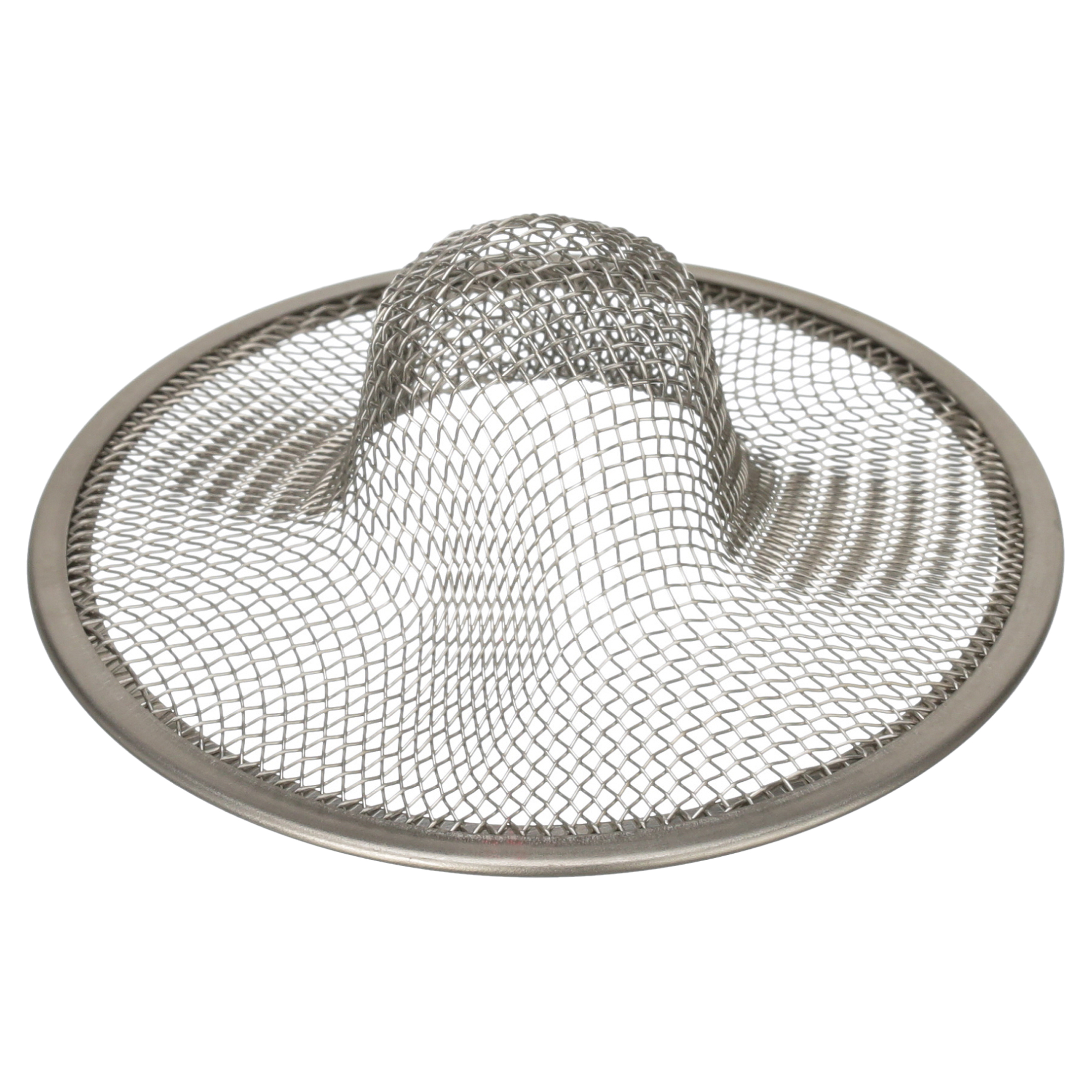

As for the engine well drain, occasional cloggery by leaves and whatnot had been my biggest issue with it. One of those smaller Walmart stainless drain screens sort of bent to fit and shape has cured that issue (see: https://www.walmart.com/ip/Peerless-sta ... s/17043474)

Like the mesh wire strainer idea!
Setting it with the ‘dome’ up would make sure that the water always has a place to drain. A longish 1/4” bolt clamped through the center and extending down into the drain keeps it in place and from wandering off....
