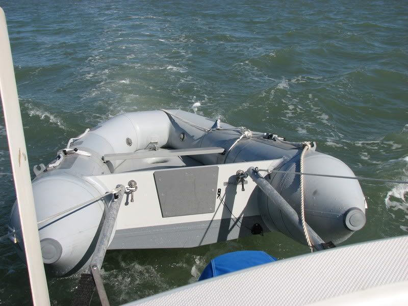

Just back from 'sea trials' today.
Weather was 8-12" chop with 10-15 mph winds. Air temp. 81 F..... :wink:
Upwind, we achieved 7.4 mph (GPS) and max throttle.
Downwind got a reading of 8.0 mph.
Next time out I'll drop to 9.5" pitch on the prop. from the current 10.0".
The dinghy behaved very well, and gave no anxious moments...... :)
I am certain we lost some performance, tough to quantify, but it's something I can easily live with.

I am thoroughly impressed. Having just bought my 2005 late last September with a seven month old boy hasn't provided me with many opportunities to sail or modify. I knew I liked the look of that Dinghy-tow product and I knew somebody had the smarts to come up with an alternative.
Now that you've done it, what are your true impressions ? Likes dislikes ?
Are you happy with it or would you continue to make changes?
Could I impose upon you for any sketches or more photos?

commocean wrote:Are you happy with it or would you continue to make changes?
Complements are always graciously accepted........
On changes with the present design? Perhaps I'll replace the painted galvinised chain with stainless,but at this point nothing else comes to mind.
The other night we had winds gusting to 35mph +, and the dinghy stayed right behind the Mac, although the Mac was doing it's usual bouncing around. I think the transom out of the water helps to stabilize everything.
I'll post more photos shortly showing more detail.
R

commocean wrote:Could I impose upon you for any sketches or more photos?
Here is a bit more detail on how things fit-up.
The above gives more detail on how the 5/16" carriage bolt which is tightened onto the anti-sway bar, can then be dropped into the 3/8" hole in the starboard lifting arm.
This shows how the 3/8" eyebolt captures the last link in the sway link setup, also the bowline on the end of the 25 ft. lifting line.
More pics are availble if needed.
cheers..........Ron

Post by Frank C »
Ron,
Very nice adaptation! With advance apology for armchair qtrbacking,
kinda wondering if crossing the lifting lines, side-to-side, might obviate the swaybar?
This might require the lines led inside the rudders, cleats adjacent to edges of the helmseat?

Post by R Rae »
Thanks Frank.
The crossed lines you mention probably would sort of balance out the various forces at play.
However, I've discovered that when stepping aft to the dinghy it's very re-assuring to step out onto a fairly stable lifting arm knowing the anti-sway bar is doing it's job in reducing excess wobble. Also the crossed lines could be another obstacle in getting aft.
