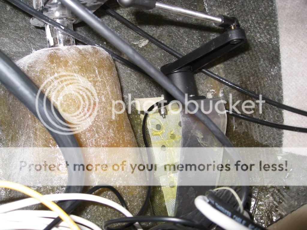

Here's where I am
http://i235.photobucket.com/albums/ee20 ... 010001.jpg
http://i235.photobucket.com/albums/ee20 ... 010004.jpg
http://i235.photobucket.com/albums/ee20 ... 010006.jpg
http://i235.photobucket.com/albums/ee20 ... 010007.jpg
http://i235.photobucket.com/albums/ee20 ... 010008.jpg
http://i235.photobucket.com/albums/ee20 ... 010010.jpg
http://i235.photobucket.com/albums/ee20 ... 010017.jpg
http://i235.photobucket.com/albums/ee20 ... 010024.jpg
http://i235.photobucket.com/albums/ee20 ... 010025.jpg

My rudder sensor install is a 5 1/2" square from the center of all four pivot points, accross the back center of rudder post to center of rudder sensor post, pivot point on rudder sensor arm to centor of rudder sensor post is also 5 1/2" , pivot post on rudder arm is 5 1/2" from center of rudder post , and the connecting rod is also 5 1/2 " center to center on connecting link ends
I drilled a 2 3/4" hole in the liner at the rear S/B aft corner next to and above the S/B rudder post see my pics on post above , then removed a very small amount of styro foam drilled two 1/4" holes in the rear of the liner through the 2 3/4"
hole at a 45% angle put the bent angled Alum flat bar in possition & marked the two hole poss. then temp installed flatbar & clamped the 3" wide Alum 3" x 2 1/2" angle onto the flat bar with sensor to get the right hieght so that the posts for the connecting link are level mark, draw a line across the flat bar, now mark your center point of the rudder sensor on the alum angle brkt as the brkt is not facing straight back but rather on a slight angle, remove complete assembly mark holes for Alum angle & drill bolt assem together with 1/4" SS bolts & nylon lock nuts drill out holes for rudder sensor & assemble & instal . The Alum flat bar is 3" wide 6" long has a 3/4" bend at the 2" mark
Hope this helps

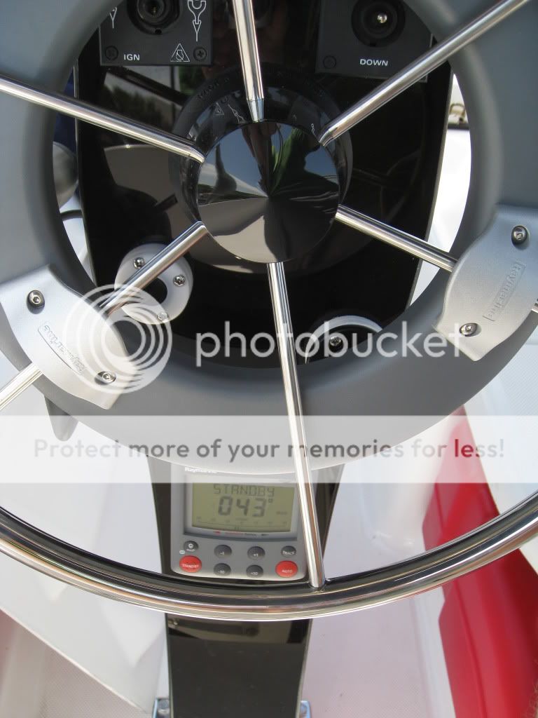

Just completed the installation and Sea Calibration and every thing seems to work fine. I did a couple of things different than what I have seen posted, used the Raymarine Bulkhead / Box Pedestal Fitting Kit # E15017. At least the flat mount rod that holds the wheeldrive from spinning, had to add a block underneath it as it was too short as supplied for the 20" wheel. Also mounted the rudder sensor on a light weight aluminum frame that I glassed on to the inside of the transom. Mounted the control unit below the wheel on the pedestal as I really could not find anywhere else the worked for my setup, it is not ideal but OK and more so since I have the wireless remote that displays everything that the control unit does and more.
http://i673.photobucket.com/albums/vv92 ... G_3619.jpg
http://i673.photobucket.com/albums/vv92 ... G_3621.jpg
http://i673.photobucket.com/albums/vv92 ... G_3623.jpg

I too used dealer settings and I think there were a couple that I changed, boat type to sailboat for sure. It is important to follow all the steps laid out in the commissioning guide including the Sea Calibration if you want the system to perform properly.

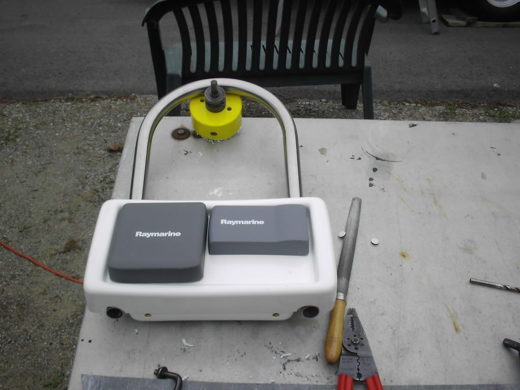

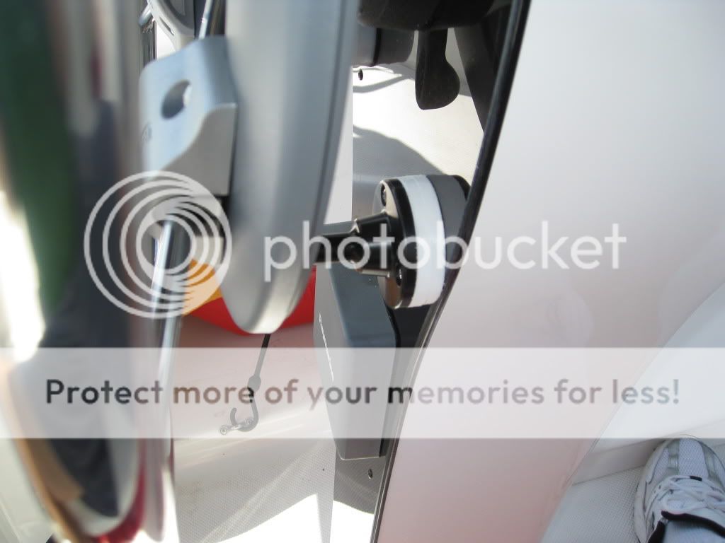

Well with my A/P wheel set up installed my RPM guage was not readable so I removed it & will re-install lower in the pedestal , so now I had 3 1/2" hole in my pedestal face to deal with so this was my solution , make a plate up to cover the hole & at the same time incorparate the anchor stud & whl motor so this is what I have done !
http://i235.photobucket.com/albums/ee20 ... 0017-1.jpg
http://i235.photobucket.com/albums/ee20 ... 010018.jpg
http://i235.photobucket.com/albums/ee20 ... 010019.jpg
http://i235.photobucket.com/albums/ee20 ... 010021.jpg
http://i235.photobucket.com/albums/ee20 ... 010023.jpg
http://i235.photobucket.com/albums/ee20 ... 0024-1.jpg
http://i235.photobucket.com/albums/ee20 ... 010037.jpg
So I am plodding along the brkt has to be fitted to the pedestal then once the fit is right the brkt will be painted black & installed
with this installation the drive motor is inside the pedestal & out of the way & not an eyesore

Very nice work as usual J

looks good so far I wish I would have thought to place the AP motor inside the console. Your instument cluster looks like it will work out nicely, looking forward to seeing the finished product....goodlluck
