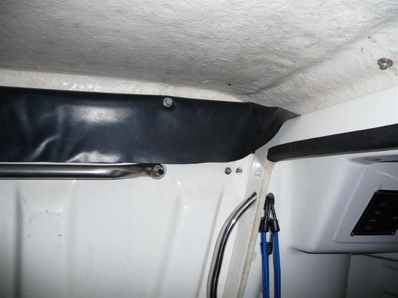

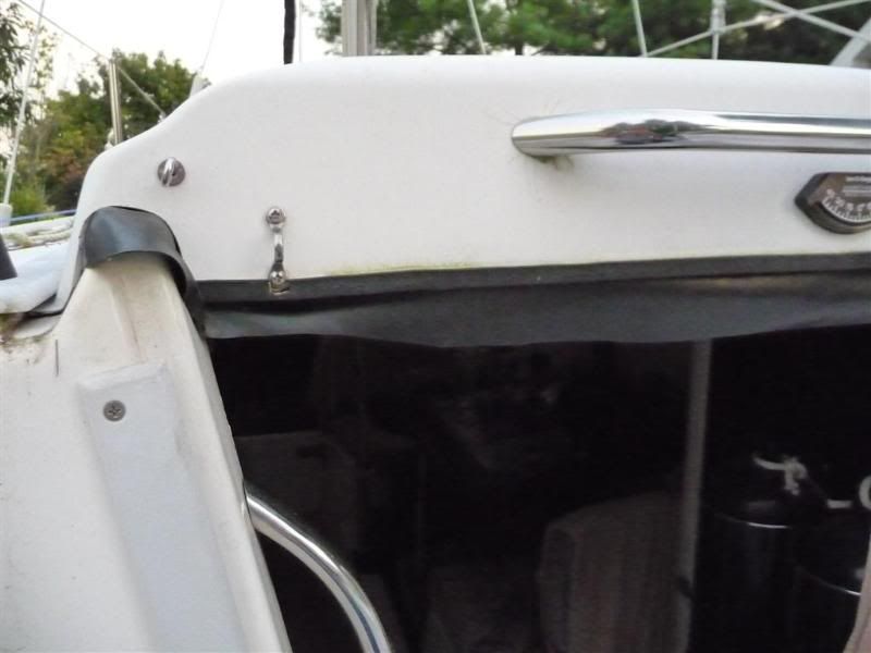

This tread has a solution by ALX357 for sealing it.cmeperform wrote:Has anyone done a mod on the main hatchway to seal it up better?
Make it water tight?
QUOTE:
This neoprene sheet is folded double, and looped over a handle inside the slider hatch edge .... then trimmed to make it cover the larger holes at the side of the closed hatch, and mostly seal the long gap between the hatchboard and the slider cover.
Neoprene sheet, like used in roofing, or tile shower under pan, flexible but tough. After any shower tile installation, there is some of this stuff left over for trash....
This hatch baffle mod, or whatever you want to call it, has been in place for about three years now, no appreciable wear or problems. It seals the gaps pretty well, and hardly ever needs any attention, just seals up against the hatchbord and those large holes pretty much keeping out wasps etc. when closed. I have three solar fan vents in the boat, and two additonal passive ones, which provide enough ventilation to afford closing this area of the hatch gaps.
The handle you might notice on the inside of the hatch-board is lined up to share the holes for mounting the outside handle, which has two threaded bolts .... The inside handle is slid over those bolts sticking in from the outside, and then held by nyloc nuts, sandwiching the board between the two handles, inside and outside. This makes the hatch board easier to move from either side, and place in this position, and also in the alternate use as a bulkhead in the cockpit at the transom, under the back of the helm seat, to cut down on sound from the motor, keep the coclpit more closed at the stern, and to keep it out of the way when the cabin is opened.
