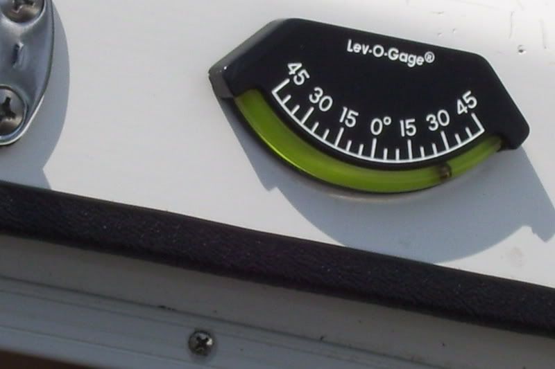

Our Lev-o-Gage only goes to 45 degrees. We have seen the little ball stop there, but Nice Aft didn't 8) The picture below shows where we keep ours.
