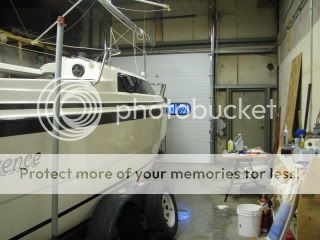

You're in for a workout. I spent nearly 40 hours cleaning, sanding, applying and polishing.
The result was worth it, but I'm gonna keep waxing her now so I don't have to
go through that again for many years. This is the Poli-glow treatment.
