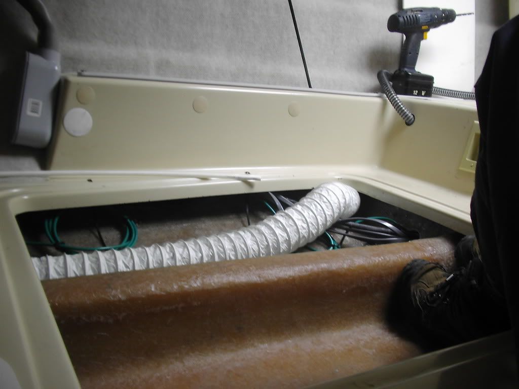

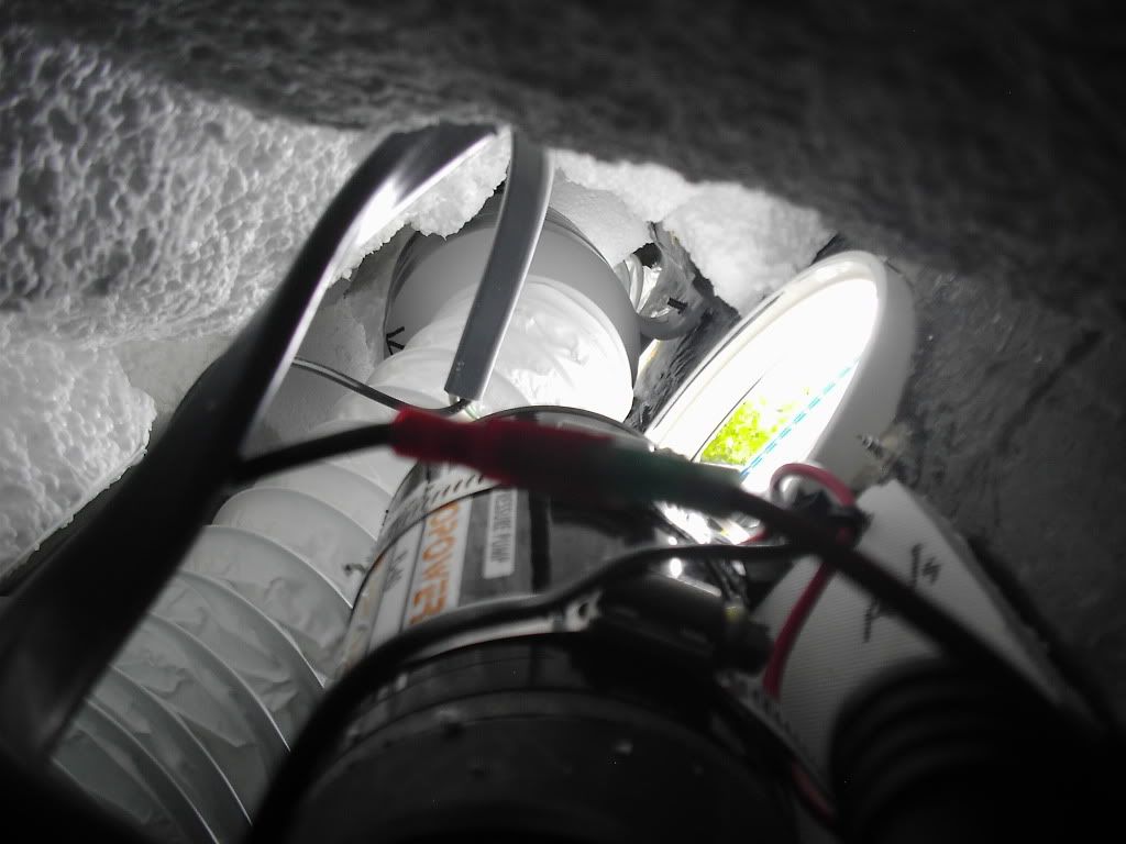

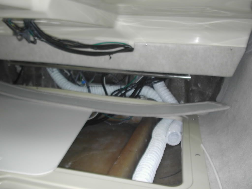

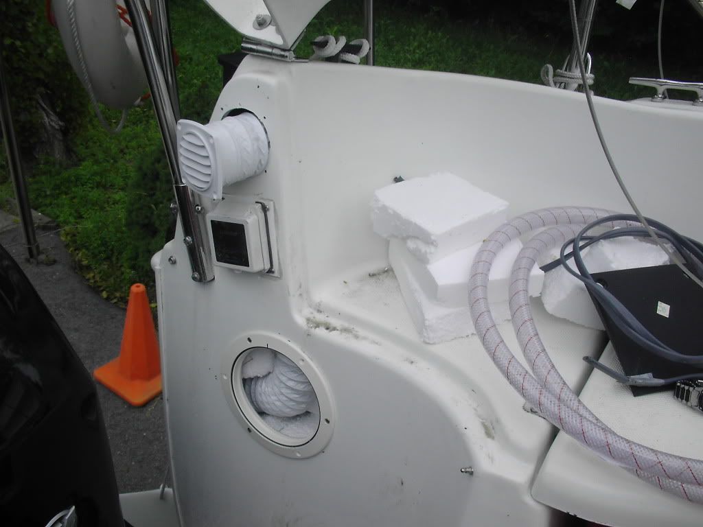

if you have inboard tanks you should consider this mod I'm working on bilge blower fan that can be switched from venting the bilge or head or both at the same time
Its legally required in canada for inboard gas tanks
but optional for the head
http://i235.photobucket.com/albums/ee20 ... 0015-1.jpg
http://i235.photobucket.com/albums/ee20 ... 0019-1.jpg
http://i235.photobucket.com/albums/ee20 ... 0021-1.jpg
http://i235.photobucket.com/albums/ee20 ... 0007-3.jpg
just to finnish off installing hard 3" pipe across the v-berth & 2 vents one in the head & one under the V-berth into the bilge area
