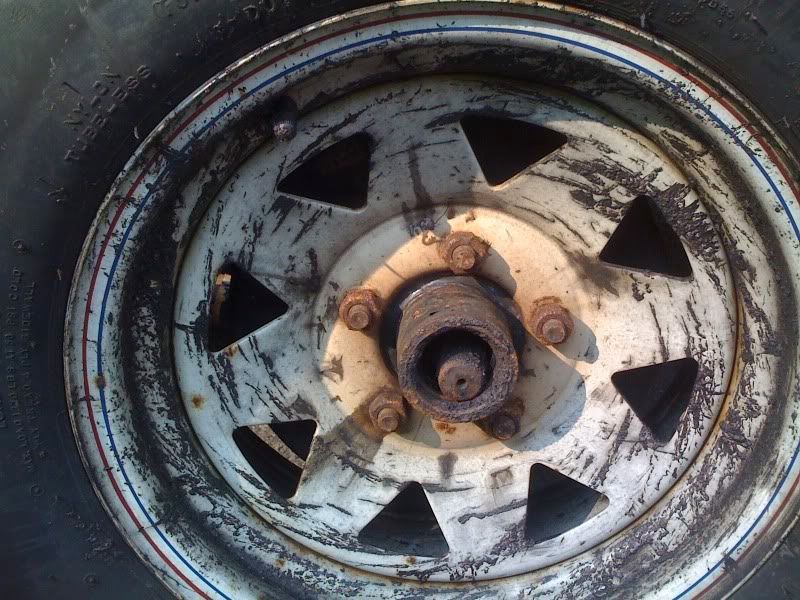

Ive had two fairly major trailer wheel/tire mishaps in the past 12 months.
Last year, between Ludlow and Albany NY (80 miles) my outboard bearing failed - when I inspected the boat the next morning, there was no bearing, retainer or nut left. The axle had been machined to a flat by the wheel snout, but it had gotten me home somehow. Apparently the brake drums had enough axial friction to keep the wheel on, even without the bearing... :? :? :? :?
The entire axle had to be replaced and I upgraded to plated disk brakes while I was doing this.
In August 2009, I trailered back from Cuttyhunk (200 miles one way) on 7 year old original trailer tires, and arrived home to find this..
Morale of the story - pay attention to your tires and bearings!! Im probably going to replace my tires every 5 years from here on out. That double axle idea sure looks good too.

Re: Trailering on a Wing(Nut) and a Prayer...
Posted: Tue Oct 20, 2009 12:52 pm
by Scott
Steven, not to disparage you mechanical know how, but............
Do you know what a pretrip inspection is? If I saw an axle end that rusty, I wouldnt have pulled it down the driveway much less across a state. The lug nuts should have been a dead give away.
Posted: Tue Oct 20, 2009 4:17 pm
by K9Kampers
That's not rust Scott...thaaaat's New England camoflage! :D

by Kelly Hanson East
That axle end was hidden inside the bearing buddy and was in great condition two hours before the failure.
I practice the Chip Hindes 'inspect every hour' mantra when I trailer.
There was tremendous heat generated when the wheel was machining the axle - Im sure that made a mess of a lot of things in there...
