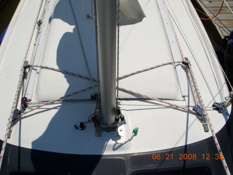

I have line run from the mast, past the stanchions, and back to the cockpit so I can rotate the mast manually in light winds. I can also force it to rotate in the wrong direction to de-power the main rather than reefing. I think others have done this mod also.

do you have any photos of these lines, or a description of the attachment points?

Photo of attachment point at mast [knot in control line creates a loop, so it can be connected to the shackle where the vang attaches at the base of the mast.
Photo showing the control lines leading aft through turning blocks [at the stanchion on the port side; using the dealer's original "halyard led aft" block that is stacked atop the daggerboard turning block on the starboard side].
Both control lines lead to clam cleats between the companionway and the winches, so the rotation position can be adjusted as desired and then "set"... handy for keeping the mast motionless when motoring or moored.

I also have a couple lines rigged up for mast rotation control along with a 2:1 purchase pulleys. They run abeam from the mast at the vang attachment out to the stantion, around a pulley and back to the cockpit. They are a nice feature in light winds and are an easy to configure & install system.
