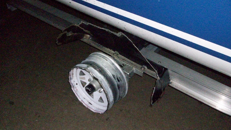

We had an excellent day sailing yesterday! On the way home, we had a massive blowout less than 20 miles from home. It was 2am and raining so I was taking it easy and putting up the hill around 55 mph. The right tire blew shredding the fender and destroying both tire and rim. They were properly inflated. I checked all three prior to this trip out.
Glad I had a spare!!! Event better, I haven't found any hull damage! Someone was looking out for us. An 18 wheeler was passing us and the whole trailer lurched left right in front of him when it blew! It shook a LOT of construction dust loose inside the boat. The table and galley were covered with fiberglass dust!
My wife found threads about tire/rim replacements but what about a 2010 fender and fender running light? http://www.macgregor26x.com/forum/viewt ... 2e3aab8482
Anyone know where I go to get a right fender? Do I call the factory or can KH or BWY get them?!!

Glad to hear there was no damage to Galactica. Hopefully you can get your trailer repaired with no problems.
Your trailer was pretty new wasn't it? How many miles you figure your tires had?

Schoolhousesteve had a simular blowout about 2 weeks ago but he has the older steel trailer with metal finders and it only took out the tire and rim. The sun is the biggest problem rotting the tires too soon along with stuff on the road. I think I will buy the runflat tires soon or get a complete second axel. If your trailer is like our trailer the steel rims are getting rusty from salt water and need replacing with galvanized rims anyway.

The trailer has a manufacture date of October, 2009. With Supersport towing it out from the factory and all the mileage I've put on it, I figure about 3000 miles. I'm glad I have a spare. I've been abnormally protective of the boat and with only a single axle, have closing monitored tire inflation. I was kicking up to 70 mph at times but now will probably stay slower all of the time.
I've been kicking around the idea of adding a tandem axle primarily because I've changed so many trailer tires on roadsides over the years. Cost and lack of mechanical skill has kept me from doing it so far. I still have the old boat trailer from my old speedboat and had even considered stealing the second axle from it but the size is different and it would not fit.
It was ironic, I removed the tie-down on the return trip yesterday because I noticed that it's rubbing into the blue gel coat and wanted to come up with some sort of padding to protect the boat. So this incident happened with no rear tie-down. ack! :o
I've noticed that a lot of mud from our gravel road splashes up on the boat even with the fender on. Now that I have to replace a fender, I'm starting to chew on an idea of extending a horizontal extension in front of and behind the fender to catch the additional mud and road debris.

Im guessing you might have hit something in the road to cause that blowout. I doubt a tire would fail that early in life unless there was a defect.
I think there is a pretty big temp difference between 60 mph and 70 mph - the energy dissipated probably goes as V2, so thats something like 36% more heat at 70. I sure like how nicely my single axle trailers at 60 vs 70.

Doug - back to your issue - in your right hand photo of the (presumably spare tire) on your trailer - that wheel looks funny to me, like it isnt mounted straight, or there is something wrong with the axle. It might be just the perspective of the picture that is fooling me.
