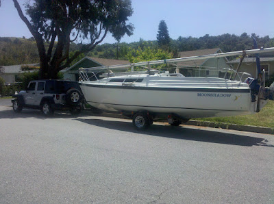

Interesting topic.
We tow using my 6 cyl 4 door jeep. Tows well considering it is a single axel. I do make sure I keep speeds below 60 mph, I added surge brakes to the trailer, and stretched the tongue out about another foot. We also have water storage up front about 20 gal in the v berth which keeps added weight on the hitch.
