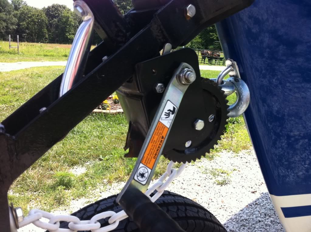

What model winch do you now use and where did you purchase it ? Also, do you have a close up pic of it ?
Frank L.

Looking at the picture Doug posted I feel sorry for M owners. Roger M. has always used incorrect geometry to set up the trailer winch but it looks like he has made conversion of the the winch to it's proper position, difficult to impossible. The winch should pull either horizontally or slightly up on the boat. Stock set-up is to pull down and work against yourself. I never do the Mac bump on either of my boats. This topic has been discussed several times. Just looked in my photos but don't have one to send. Let me know if someone wants to see it. :idea:
