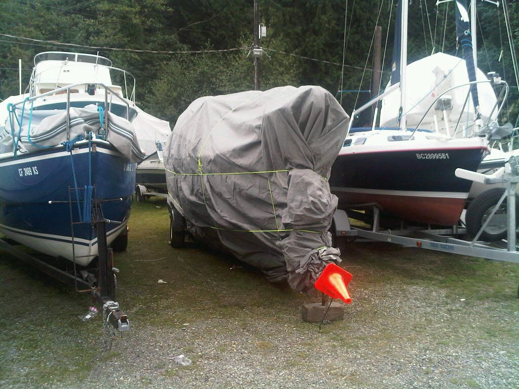

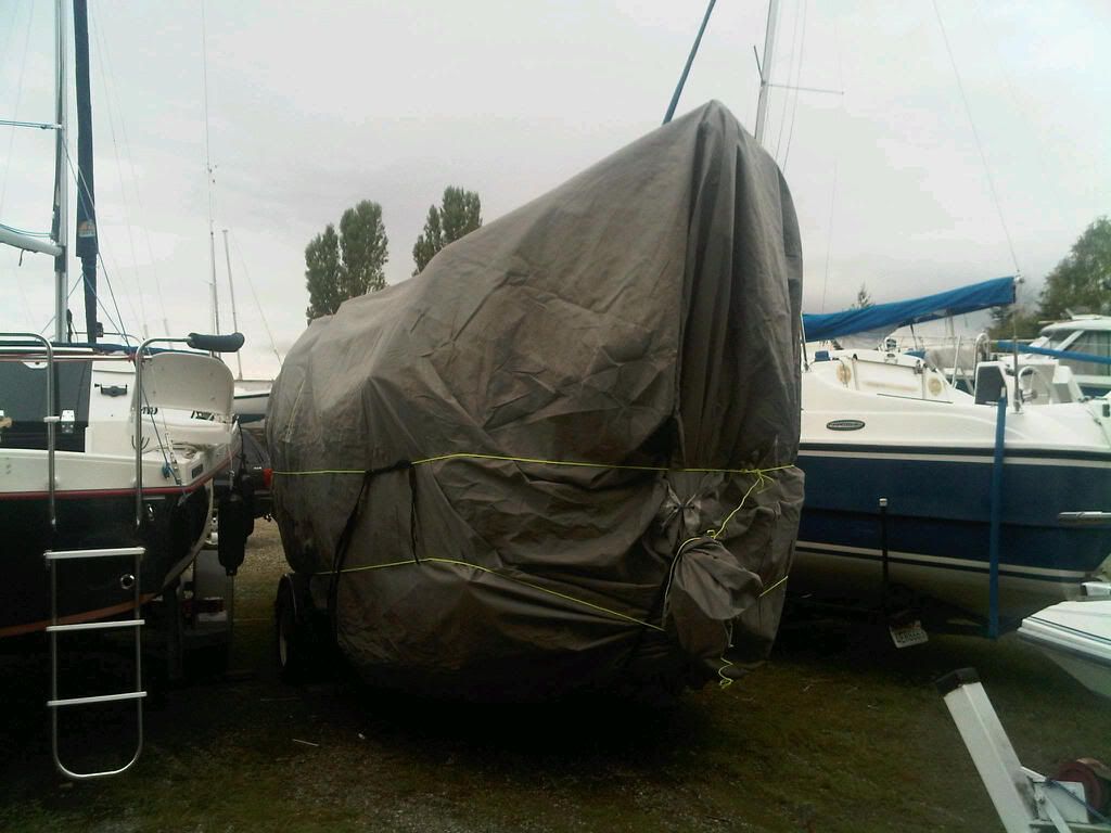

I built a frame out of white plastic pipe.
1) I put on a sunbrella boat cover over the frame
2) next is a 20x30 plastic tarp
3) then a grey 30 foot RV cover.
4) all tied down and snug as a bug for the winter.
5) I check and refill the 4 bowls of moisture crystals at least every 4 weeks.

You get back in the boat to add moisture crystals?

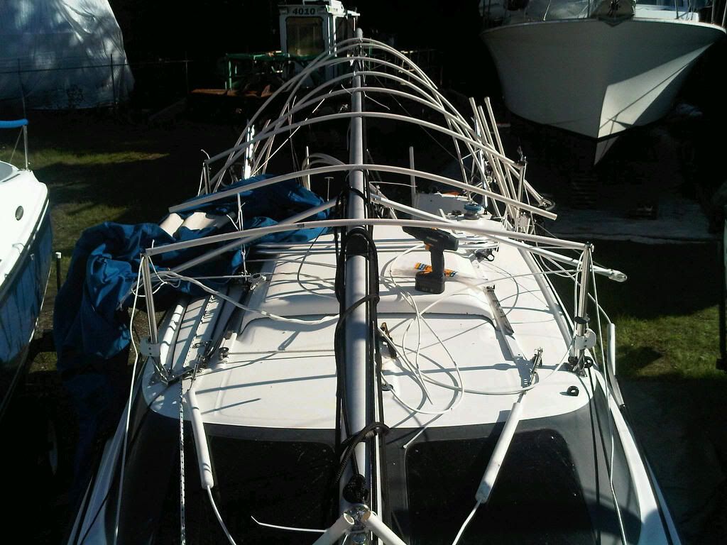

The PVC tubes work great with a cheapo tarp. I'm going on year 4 now. I think this is the last year for it but I don't have much invested.

How are the ends of the (I'm assuming 1/2" sch. 40) tubes supported, if at all? What you did there looks really good to me.RussMT wrote:The PVC tubes work great with a cheapo tarp. I'm going on year 4 now. I think this is the last year for it but I don't have much invested.
I have a 30 ft cheapo tarp (but not the cheapest - it's 'heavy duty', per the package description

Ditto - looks very practical.
I have a 30 ft cheapo tarp (but not the cheapest - it's 'heavy duty', per the package description) and was just going to use the mast to support it alone, with a short mid-span support for the mast at the tabernacle, but I like the concept and execution on yours. Seems to solve the issue of the lifeline stantions poking at the tarp, too.

In the photo, I used wire ties to hold the 1/2 PVC to the stanchions. These tended to slip off, so now I go low tech. I wrap the stanchions with paper towels and strap the PVC pipe to them with duct tape. The paper towels keep the tape from sticking and easy removal in the Spring.tkanzler wrote:How are the ends of the (I'm assuming 1/2" sch. 40) tubes supported, if at all? What you did there looks really good to me.RussMT wrote:The PVC tubes work great with a cheapo tarp. I'm going on year 4 now. I think this is the last year for it but I don't have much invested.

Then you have to be creative. On the bow where there are no stanchions, I pinch them on the deck "rails" and tape them to the lifelines to keep them from slipping. The spring of the PVC hold them in place for the most part. I think I may have also attached them to the mast in the center with some cord.
I stole this idea from someone on this board and it works extremely well. We get quite a bit of snow and it sheds most of it. The cover does wear through as evident on the top of the picture above, but it keeps most of the junk off and I'm too cheap to buy another $65 cover.
You could cover the mast crutch and any place contact is made with the cover with something soft to protect it.
Once covered, I lace the whole thing up under the trailer like a shoe. My roller furler sticks out the bow and I cover that with several garbage bags. In the photo above, I took it off, but I don't do that anymore.
