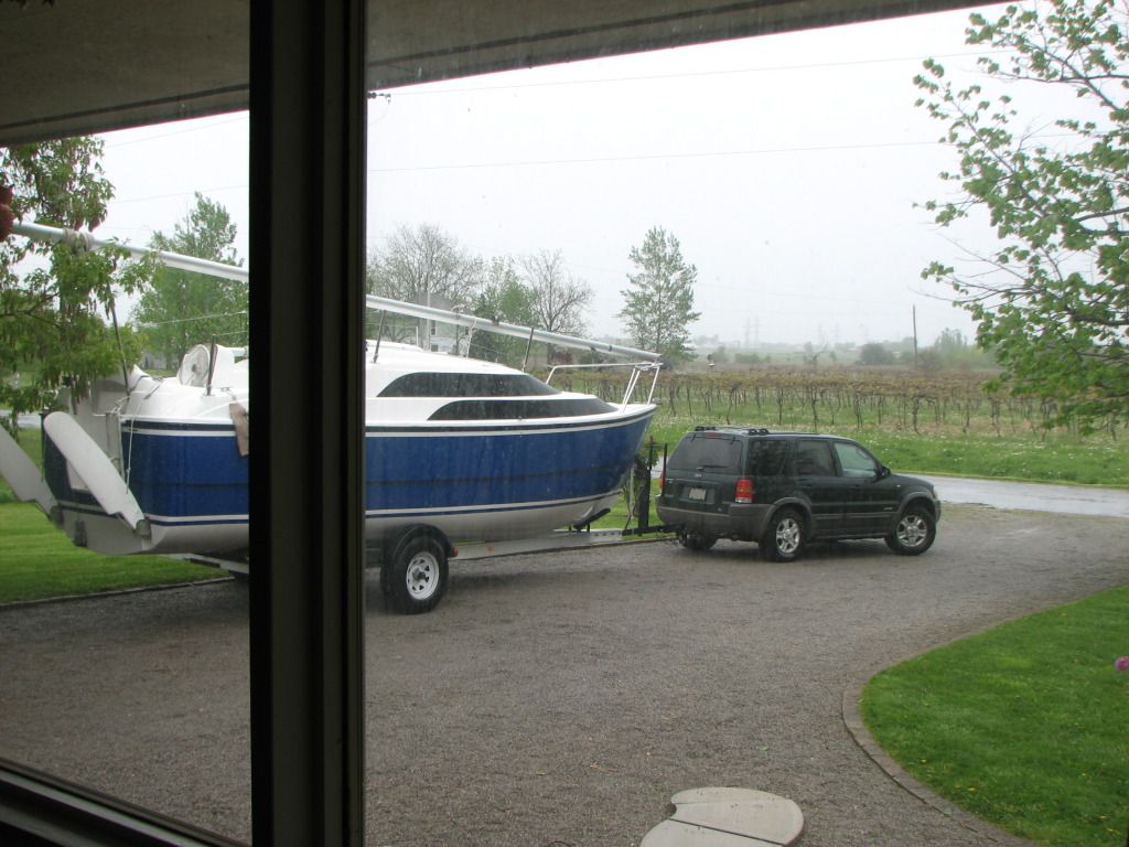

Sometimes (well - most of the time!) I'm accused of having my reach exceed my grasp. With the limitations of fixed retirement income, and the ever present desire to pursue other mods as well, I'm having to extend the lifetime of my little Ford Escape for towing my 2010 :macm: . That being said, I find myself looking into sway control solutions to take away some of the craziness on the highway during truck passing's, and high winds.
Yes, I can hear the chorus - particularly because of some of the excellent reviews here concerning better choices for a tow vehicle - but (and my personal next option would be a Ford 150 4WD) has anyone had any experiences with these various products that they would like to share?

All the answers are right on as far as tongue weight, There are two other things that effect sway. If the Trailer is not level when towing, and I'm sure its not with an escape (we own one) the trailer will sway. The other is your towing at least twice the weight, twice the tongue weight, that ford recommends for that car. That's not safe at all, the stress you are putting just on the factory receiver hitch can cause it to break, your axle cant take that kind of pressure, and the height of the mac on the trailer will act as a sail on the road and just blow you around at will.
Its really really dangerous what you are doing, I almost thought you wrote this question as a joke, or something. Your car is rated for something in the line of a harbor freight trailer for towing, the mac, although light for its size is way to much for the escape. I would get under the car and check the bolts holding the rec. hitch on, look for damage. The rec. hitch that comes from ford is only a 1 1/2 rec. Not the three inch standard you would need. even the adapter that would allow you to use a three inch plug in would bend when towing, the inch and a half plug in is not rated for 300 lbs. tongue weight.
You really need to rethink this, you lose the mac on the freeway, and people get killed, it will cost you way more than a 5000 dollar older truck you want to tow with. Depending on what breaks, your car could get out of control too, so losing the car, your life, is a possibility too.
Please don't tow this setup anymore, even the ford escape tires are not rated for this kind of towing.

Mike, it's not often I get b*tch slapped with such accuracy - but you're 100% right! Though my hitch is not the weak factory model and my shocks are uprated, there is an abundance of truth in the possible scenarios that you've laid out. Clearly this vehicle must be replaced, and will be replaced when we turn our property this spring. I was wishing out loud for some kind of a miracle 'add-on' to mitigate some of the worst habits but I always felt the only true way - as you (and others) pointed out - is to upgrade to a better towing package.
Apart from a few lucky trips in the past, we only take slow country roads now, to our launch point twenty minutes away on Lake Ontario. Once the season opens we'll be staying in mast-up storage until I find the next vehicle and can get into the longer ranging expeditions we're hoping for. Gonna miss the escape though - that's one plucky 'little' car!
