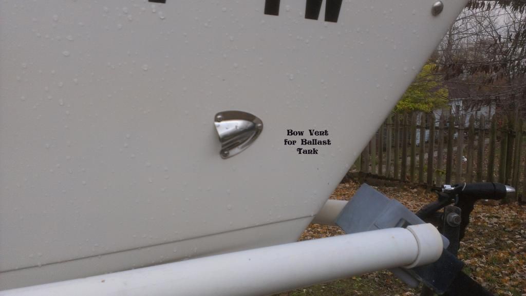

Chameleon has a similar system for the front vent, however our vent is run up the bow with reinforced vinyl tubing and controlled with a ball valve.
It is then vented from the starboard side:
