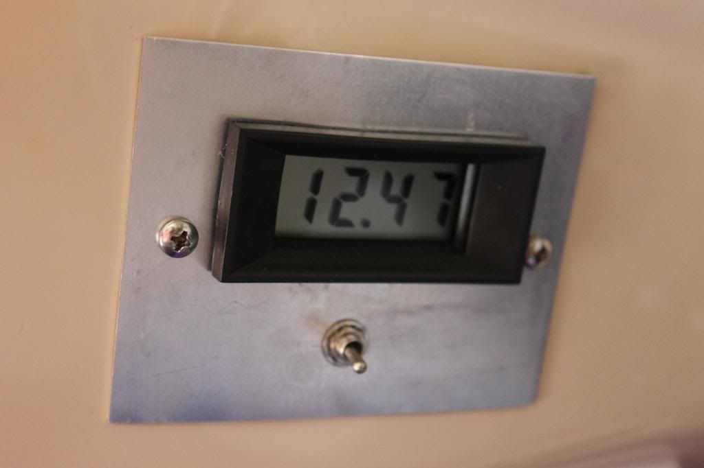

I wired a digital panel mount voltmeter with an A/B switch to monitor house and starting batteries. The digital display replaces an analog meter and is much easier to read.

This is the panel I modified with a digital voltmeter. The analog meter was a piece of ........[that which makes things grow] (I have two, one a replacement from the manufacturer for the defective first one).Starscream wrote:I just installed a battery monitor this weekend. Here is the model that I used: http://www.entrepotmarine.com/fr/electr ... ie-ca70060. The total job cost less than 25$ and the wiring was simple. The meter comes with one black wire and two red wires. I installed a 5/16" ring clamp on the end of each of those wires ($3 at Canadian tire) and attached them directly to the wing-nut terminal on each battery. The single black wire goes to either of the negative terminals, since they are wired together they are the same thing. I didn't mess with the selector switch at all.

I like the idea of digital, and being able to read either battery. Can this voltmeter be turned off when not in use?RobertB wrote:I wired a digital panel mount voltmeter with an A/B switch to monitor house and starting batteries. The digital display replaces an analog meter and is much easier to read.
Re: Wiring a voltmeter on 26M
And it is better if it is so when not in use you can turn it off to help reduce parasitic drain.Phil M wrote:I like the idea of digital, and being able to read either battery. Can this voltmeter be turned off when not in use?RobertB wrote:I wired a digital panel mount voltmeter with an A/B switch to monitor house and starting batteries. The digital display replaces an analog meter and is much easier to read.
