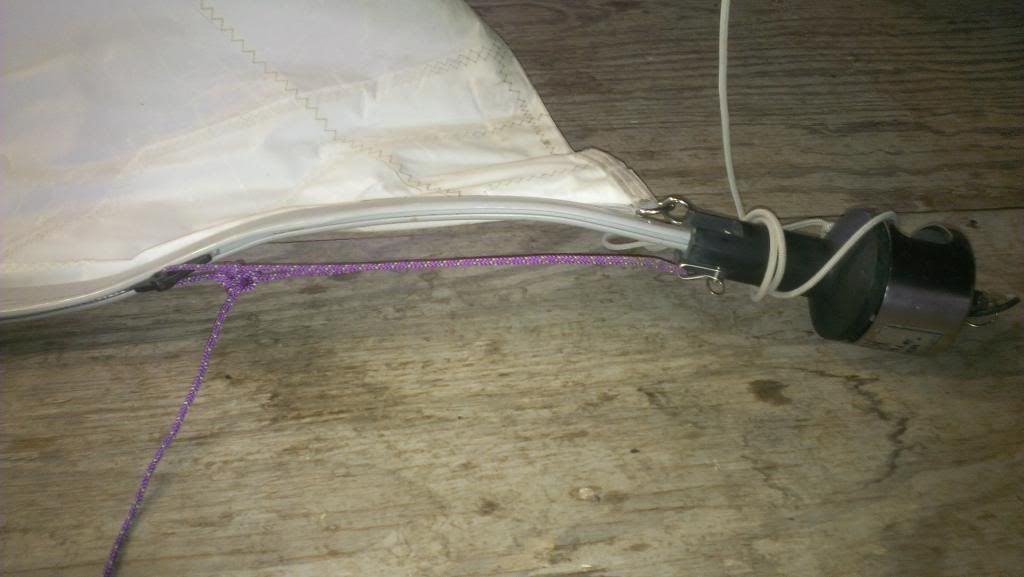

I am just beginning to get an inkling about how this works. My genny is lashed to a line at top and bottom, but I had not realized until I took a good look at it, that that line runs freely inside the furler. I did not know that the sail would slide on its boltrope out of the furler while the furler is up.
If I were to untie it at the bottom and tie a line to it, I could bring down the sail! And if I had a jib with the same boltrope, I could change them in a jiffy! It's .. it's almost like they planned it this way! :P

mastreb wrote:And if anyone has figured out how to get the last two inches of hoist out of the internal jib halyard, let me know. My new genny is baggy at the bottom because I can't get enough tension on it.
By the way, JudyB read this post and called me while on my trip to give me some ideas for how to tighten up the jib halyard. She recommended using a halyard bend instead of the double-bowline I'd used, which shortened the knot at the top enough to take up all the slack and eliminate the bagging at the bottom. Thanks Judy!
