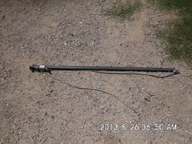

Here is a pic...It looks complete...I can't make out the sticker...it is 57 inches long
As far as how much? I was thinking
However you could also make an offer..It's nothing I need

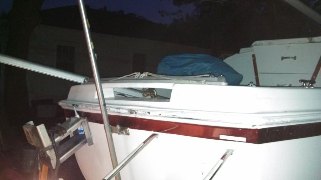

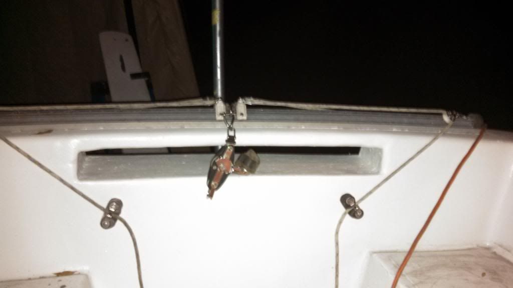

So... got caught up in some family stuff and work so its taken me awhile to get back online but here is what the boat looks like now if people are still interested. Its not too big of a job if you have the know how and happen to have the materials lying around! So far it works great guess I will just have to wait and see how long things hold up. Oh and sorry in advance for the not so good cell phone camera pics. Its not all fuzzy and lumpy just looks that way for some reason in some of the pictures
