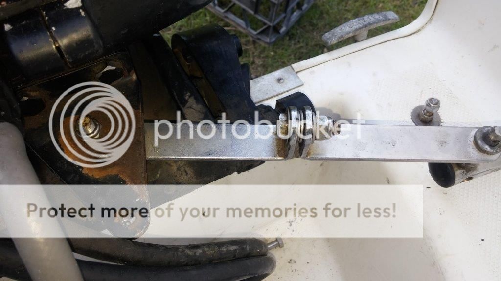

Then I started to wondering about which connection on the OB should be used. The picture below shows it's currently connected to the one closest to the cowl. This makes the OB stays parallel with the rudders but it's also the heaviest leverage point ..... Is it important that the OB stays parallel with the rudders for low speed maneuvers and backing up? ... if you have a Mercury 40/50/60HP which connection hole are you using?
Also, shes currenly pulling quite hard to starboard at higher speeds so I need to set the OB Trim Tab. I currently have the the Tab trailing edge set slightly to port but just read this on another forum ...."For example, if the boat pulls to starboard, move the trailing edge of the trim tab to starboard." ..... is this correct?
One last point. My OB leg is way too low as both plates are well below the water line (no ballast) while under way, would it be good to raise the OB a couple of bolt holes?
