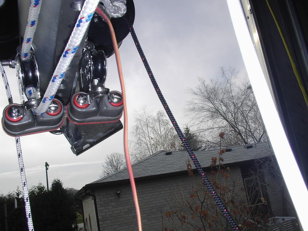

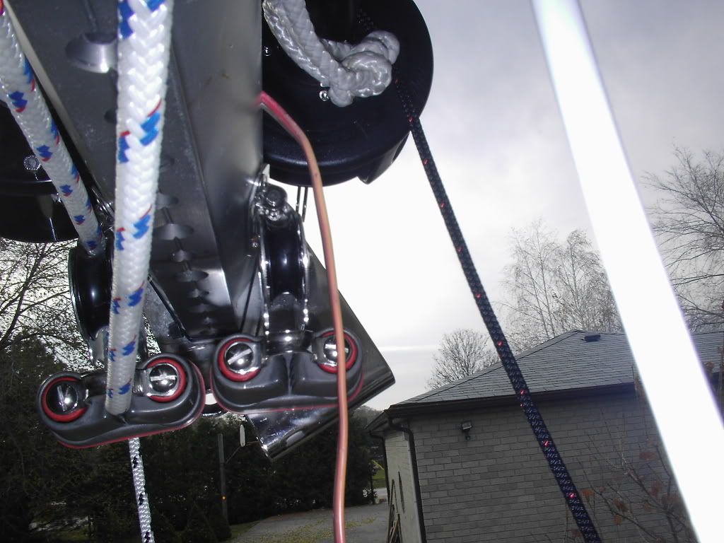

I installed two of these
http://i235.photobucket.com/albums/ee20 ... 010014.jpg
http://i235.photobucket.com/albums/ee20 ... 0012-1.jpg
on the base of my mast , but because of my dodger they r a pita to get them to release so I am contemplating on removing the cam cleats from them & moving them aft under my dodger
if u do not have a dodger they will work fine

So Ray, your Haylard is running down the front of your Mast? .... But what happens to the Haylard at/near the base? .... Does that setup effect mast swing?

Yes thats all u need just pull on the halyards to get them where u want them then cleat off , Harken 140 is rated working load of 300# & breaking strength of 2000# which is more than plenty for our halyards no need for a rope clutch , because my dodger interferes with it I have to use a boat hook to get enough force to uncleat them , so I,m thinking of removing the cam cleat from them & moving the cleats further aft poss. beside my rope clutchesSENCMac26x wrote:I really like this idea, only 1 piece of hardware to install, it's a lot more KISS than having lines weave through 2-3 blocks before getting to a clutch/cam.
Question, what working load do you think that piece will need? Do you plan on use the Cam as the only thing securing the line?
