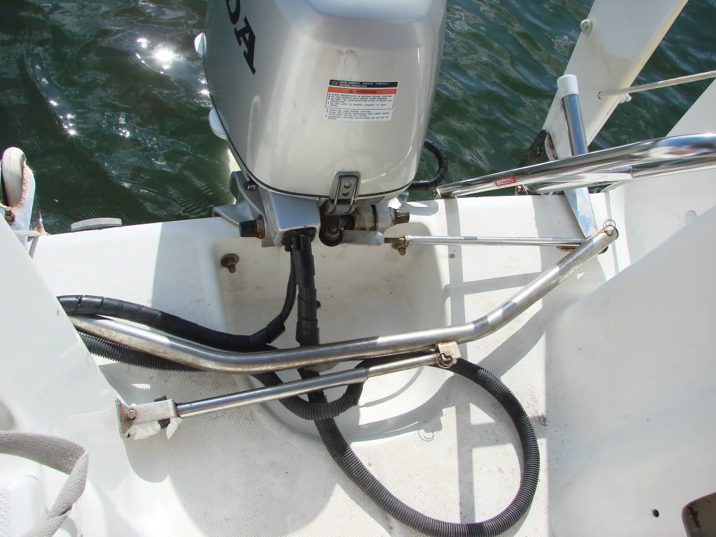

My 26M has a Suzuki D60A outboard (great engine!). Have just noticed that when the motor is up for sailing and attached to the fixed point so it won't fall to the side (in other words the steering drives the rudders only, not the weight of the
motor) the arm that steers the motor (which is not attached to anything) will run up and hit the motor and electric cables at full wheel travel. It can even catch under the motor, locking the steering wheel. Is there an adjustment somewhere
that will prevent this interference?

You're detaching the steering arm from the motor?
I have a :macx: so I don't know the config of the :macm: , but on X's you detach the steering arm at the other end - the end that couples to the rudder yoke. It's just a simple cotter pin.
That way, it stays stationary with respect to the OB.
In this pic, on the far right, you can see a ring ding attached to the pin that joins the rudder yoke to the OB steering arm. That's where we disconnect.
(Oddly, this is on the port rudder. I think on almost all Macs - including mine - its actualy on the starboard rudder)
