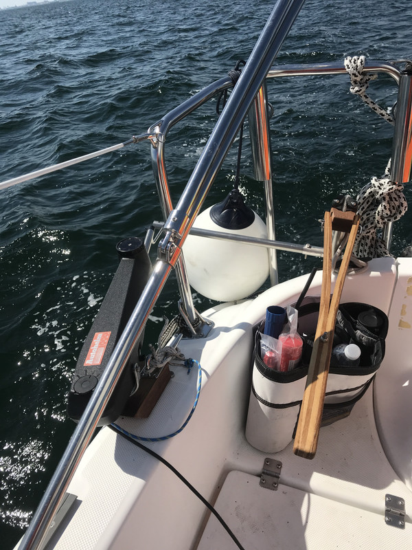

Russ, BOAT - thank you for comments :-). I did see another less fancy version of the "autopilot under the bed" version and of cause the "classic" donut on wheel before I made my choice. I had 3 reasons for finally going for what I did...in order.
1. Price - this has cost me only 60$ for an old autohelm1000 and a steel pipe from the scrap yard.
2. Emergency steering - have had a few discussions with myself how to get home if the steering cable should fail.
3. Tiller steering - although the wheel steering is nice, sometimes I miss the direct feel of tiller steering.
I am still working on finalizing the setup above deck - will post pictures when finished :-)

And I agree with all of your reasons - for one thing using a standard tiller portable unit is good because of the price but also because they are easy to replace and as technology progresses you can get improved units. It's less complicated removing the AP from the rudders too.
Emergency steering is ALWAYS a good idea for a sailboat that has a wheel - wheel steering is prone to failure - tillers always work. (And I agree - they feel better too).

So I finally got to the live test on a two day trip. Works wonders. Used the auto for some 6 hours. Mostly with the motor and steering wheel disengaged, but For trst also ran it with motor and wheel and it worked as well - but probably wears more on the Autohelm.
