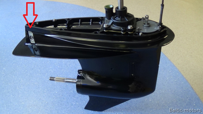

by Russ
I don't know why they would change it that much with the "A" version.
I have the 2008 DF70 and this is where the anode is located.
I can adjust the upper limit on the tilt and when tilted up, the skeg skims the waterline or is just out depending on how loaded the boat is.
Re: External zinc location lower unit DF70A Suzuki
Posted: Thu Nov 05, 2020 2:01 pm
