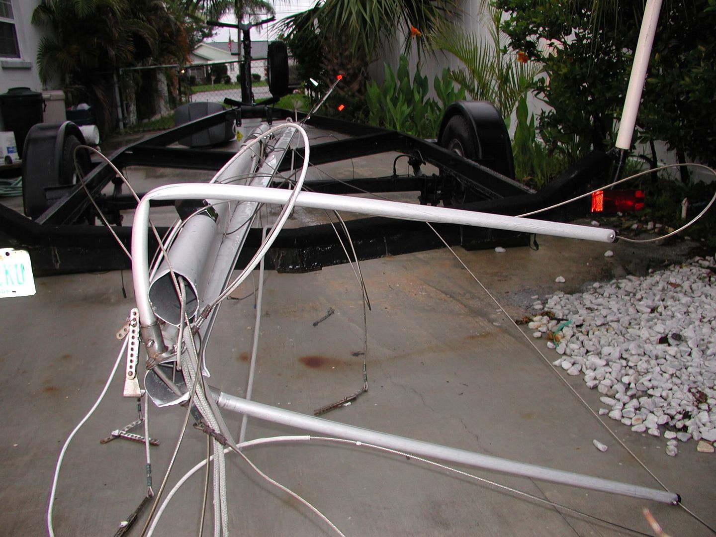

Yes Frank, you can add me to the list you've been keeping and it broke right at the spreaders through the bolt hole. Also pretzeled one of the spreaders.
But I figure if it hadn't broke there, it would have broke somewhere else...so even if you reinforced that area, it would probably just break right above the reinforcement. You may be able to notice from the pic that the mast is bent really bad right around the break so it would have probably been totaled even if it didn't break into two pieces. The other bad thing after 3+ years of Mac ownership is that I had just gotten all the rigging tension perfect finally a couple months ago.
So now, I have to decide whether to try to have one made here or get a Mac dealer to try to piggyback one onto a boat shipment. A sailmaker even suggested trying to sleeve and weld it back but I don't think that is going to be a good option. My other decision is whether to make an insurance claim or not. I have a $500 deductible which seems to be about the price people are paying for bare 26X masts. Or, I could pay more to have a better one made locally and make an insurance claim to pay for it. Not sure if the insurance company would consider that a real replacement value though. What do you folks think I should do?
I saw Normo's post about getting one from BWY...didn't know they shipped boats to FL but then even Bill told me he has been selling to Florida customers from Wisconsin lately. There are no dealers right in the Tampa area so it would still be a drive to pick one up. I guess this would be the cheap way out with me having to transfer all the goodies from the old mast to the new myself. Probably would not be worth making a claim for anything less than $1K but then I could at least get a rigging shop to do all the tedious work.
Oh well, live and learn...I came home and immediately took the mast and all the rigging off the boat (to avoid all the questions from passersby). Now I'll be a powerboater for a while but hope to be sailing again by November when the good sailing season hits. Sheesh, I missed it last year due to my engine overheating saga, now this. :(

As far as repair goes, with the mac being tender to start with, the extra weight that high aloft of the sleeving and weld, would be detrimental, IMHO.
Same goes for the locally acquired mast. compare weight carefully.
Here's an idea, though. Check out the boat salvage yards for a length of carbon fiber mast that can be cut down to size. Great opportunity to upgrade. Turn this lemon into lemonade.

If you "upgrade" to a stiffer section without upgrading the stays, chainplates, backers, etcetera, you will almost certainly be overloading your entire standing rig and will have a problem getting proper mast bend, which in turn will damage sail shape. If you change the section width or shape, the standard hardware, particularly spreader sockets, will not fit properly; using the standard stuff anyway is inviting problems. Stick with stock or be prepared for additional effort and expense to get things right.
As long as everyting else is sound, and if it meant getting back on the water sooner, and could be done at reasonable cost, I wouldn't hesitate to do a welded sleeve as a temporary repair, while waiting for a stock mast to arrive.

Dimitri - sorry for the event, but glad it worked out without injury. I saw one other report of catching a shroud on a daymark, with exactly the same result. But that was a new Mac owner, and I think it freaked her out ... she very shortly sold the boat!
I think we hashed over this idea pretty thoroughly once before. If the damaged mast is not bent too badly, Chip's no doubt correct that a sleeve is a valid option ... in fact, I think it's preferable to changing the mast to a different section. At least the old mast is the correct weight with jigged holes and matching hardware.
And you know that it's gauged properly for the hull. Any larger mast section might require larger standing rig. That would overstress the hull, which must restrain the pull of all rigging versus the mast. Wonder if anyone has a bent 26X mast - wd be great for cutting a 3-foot sleeve.
Also agree with your observation that the spreaders are the obvious spot for a mast failure. That's where many forces are concentrated, which is exactly the reason that I abandoned any attempt to reinforce the mast ... at least it's a known expectation at the spreaders.
My preference would be replacing with a new 26X mast, but I'm not sure they exist any longer! :|

replace the mast!
call Bill at the plant to see if there are any alternatives.

There was another X owner down in the Tampa area who lost his mast. He replaced it with an M mast.
I've talked to Todd at BWY about doing this. It's a pretty straight forward change, but you would also need to buy a new main. Perhaps it's time for a upgrade of your sail as well. He feels that when a X needs a new main it's always something to consider as you get a new stiffer, taller rig for not that much more money than the sail alone. He feels there is no problem with an X carrying the bigger sail.
Give them a call (closed Mondays) and see what the options are.
I asked about getting a scrap of a broken X mast for a project I have and he indicated they replace at least a half dozen broken masts a year up here in Seattle.

Sorry to hear about the incident, but you are indeed lucky that the only casualty was property damage. In my opinion, the mast is the most important piece of rigging on your boat. I would replace it rather than repair. If it was me, I would always worry if the repair holds up... the piece of mind is worth the few extra bucks. I would think twice about going with an M mast, which is 2' longer. An X owner in my marina told me that the X doesn't have the 300 lbs permanent ballast which the M has. I didn't know that. For some reason I thought he was incorrect, but didn't really want to debate the issue, since I figure he would know his own boat. If this is true, adding 2' extra mast with a 300 lb difference in ballast may actually cause your boat to perform worse. Just my guess. I'm sure that wind and sea conditions will play a major role in this. If costs hit $1k+ with $500 ded, I would make the claim. Hey, we all pay the premiums. Sometimes it's time to collect.

Tampa Mac is the guy who replaced his X with a M mast. Airline pilot with a sexy mate. See if you can find him in the member's list and try to contact him.

I bought a mast from Gateway Sailing, at the time they were in Fort Myers, Fl, but they have moved to Punta Gorda, and merged with another sail dealership, but I don't know the name.
I paid 4 or 5 hundred plus $100 shipping, and changed the rigging
myself, no big deal.
I gave the bent mast to Normo, I don't know if he used it or not.

I know how heartbreaking a dismasting can be. I've been involved in three where the mast actually broke over the course of my sailing career! Two of them we actually repaired. One was a Lightening with an aluminum mast. We made a sleeve and the boat owner learned how to weld aluminum. We fixed it that night and it ended up being a permanent fix. I wouldn't rule out doing this to yours.
The other mast was wood (a C-scow) and was hollow. We made a wooden plug out of a 2 X 4 and put an aluminum sleeve on the outside. This was years ago and I still sail the boat.
