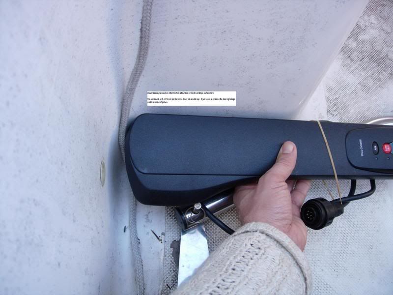

First good look at the mounting problem of the TP.
I havent decided if I will drill out the end of the TP (cup and round ball mounting pin) or leave it stock. It doesnt look easy to rig the stock pin into the steering gear so Im leaning to the drill out option.
There isnt enough room to fit the TP exactly perpindicular to the link bar on the motor/rudder combination, so it will be offset slightly. Given the over rating on the thrust, this shouldnt be a problem.
The movement of the link bar limits where you can mount the TP to the rear deck, pretty much dictating that the TP has to mounted up on some sort of bar above the linkage. Piece of wood will do it, Ill probably use this as a trial since I wont have to drill any holes in the boat either.

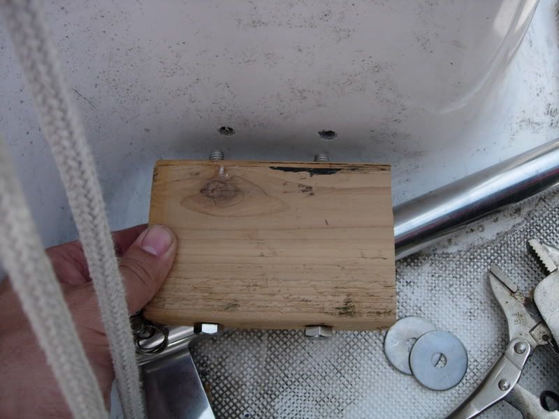

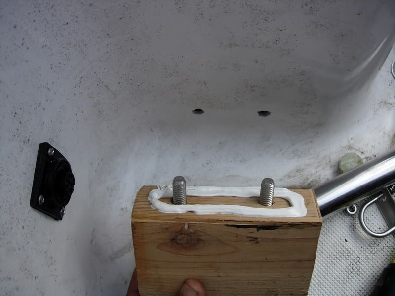

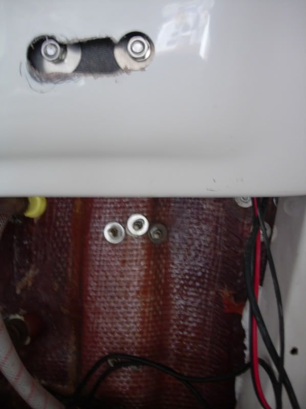

TP mechanical mounting
I took a block of deck cedar and drilled two holes in it.
4 1/2 inch SS bolts through it and carefully drilled two holes in the port transom of the boat for mounting
I gorped it with 5200 and then attached it to the boat
For the bulkhead electrical connection I considered putting it in the footwheel in the cockpit but then worried it would get stepped on and snapped off - then I noticed a white plug already in perfect place on the transom, so I just enlarged the hole and put the plug there!
On the inside, I opened up the holes to back the bolts with 2 inch fender washers. An easier way to do this is to drill 1/4 inch pilot hulls first, then cut the 2 inch holes through the liner with the hole saw. Using a hole saw without a guide drill is tough.
Fender washer, lock washer, nut is the order of the day.
Last step will be how to attach the TP pin to the SS guide bar.

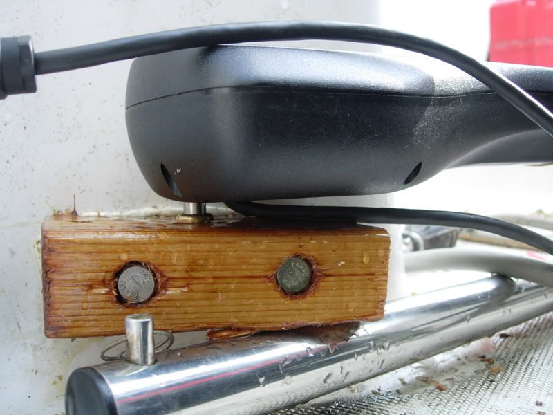

OKay I went the route of cedar block and Ubolt
This means the whole TP mod involved a sum total of two holes in the boat.

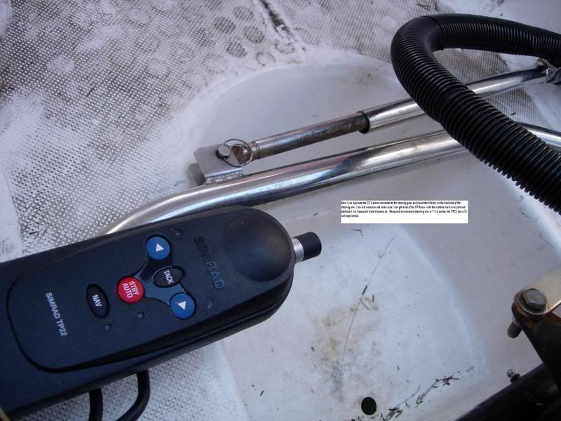

I connected the power up and it works great! Will swing rudder and engine through the whole helm range
You cannot turn helm with the TP attached.
It pops up with hand pressure - kids can do it. I will have a lanyard on it so it can be popped off quickly if needed.
Shot from rear
Close up of rear TP mount
The steering bar just clears under the wooden mount - watch this clearance carefully

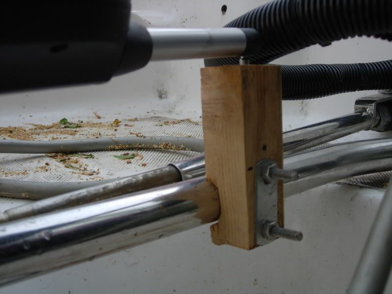

Close up of steering bar mount
Two subtle things here - the wood must clear the transom deck when hard over to port, so it cant go too far below the bar. I shimmed up the bar with a couple of fender washers to add a little extra clearance
Note the cutout on the wood which gives it firm contact with the steering bar - if you dont have this it the TP will just tip the wood.
