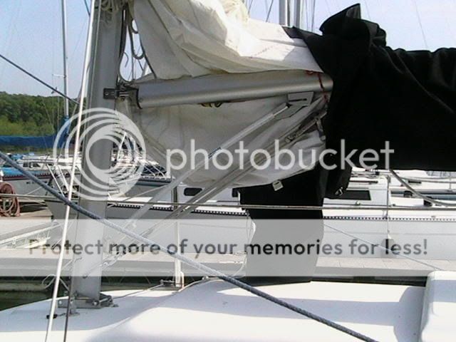

Our Boomkicker is one of my favorite additions to the boat. They come with 2 thickness of tortion rods. We use the lighter ones. I tried the thick ones but it made it difficult to vang the boom when running.
Be careful when comeing off of the foredeck if you use the boom to steady yourself. The boom will dip and swing when you grab it.
The hieght of the boom is infinitly adjustable as the mast side mount rides in the luff groove. We keep ours jus high enough to clear the bimini.
Its sweet not having to deal with the crutch every time you drop sails.

I did find the comment interesting re: controlling sail shape with a topping lift. This was new to me as ant boat Ive sailed wwith a lift, you release or relieve the life as you raise the sails. Anytime Ive seen a topping lift tight while sailing you get a lot of leach flutter?
With the vang I can easily control the heighth of my boomWith either, you need a conventional boom vang to complete the package, but the topping lift gives precise control over boom height and sail shape. The boomkicker, being a spring device, does not.
I wouldnt rely on my kicker to retrieve someone, however the halyard to the outhaul would convert the mast to a crane. possably not enough purchase to hoist someone but it could support them until you got a sling on them.It's only an opinion, but the pictured boomkicker looks way too flimsy for either of these.
