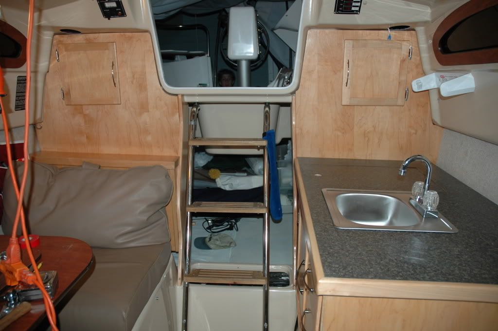

Some more progress pictures. We are almost there. Some more nuts and bolts, a little warmer and we are ready to go on the water.

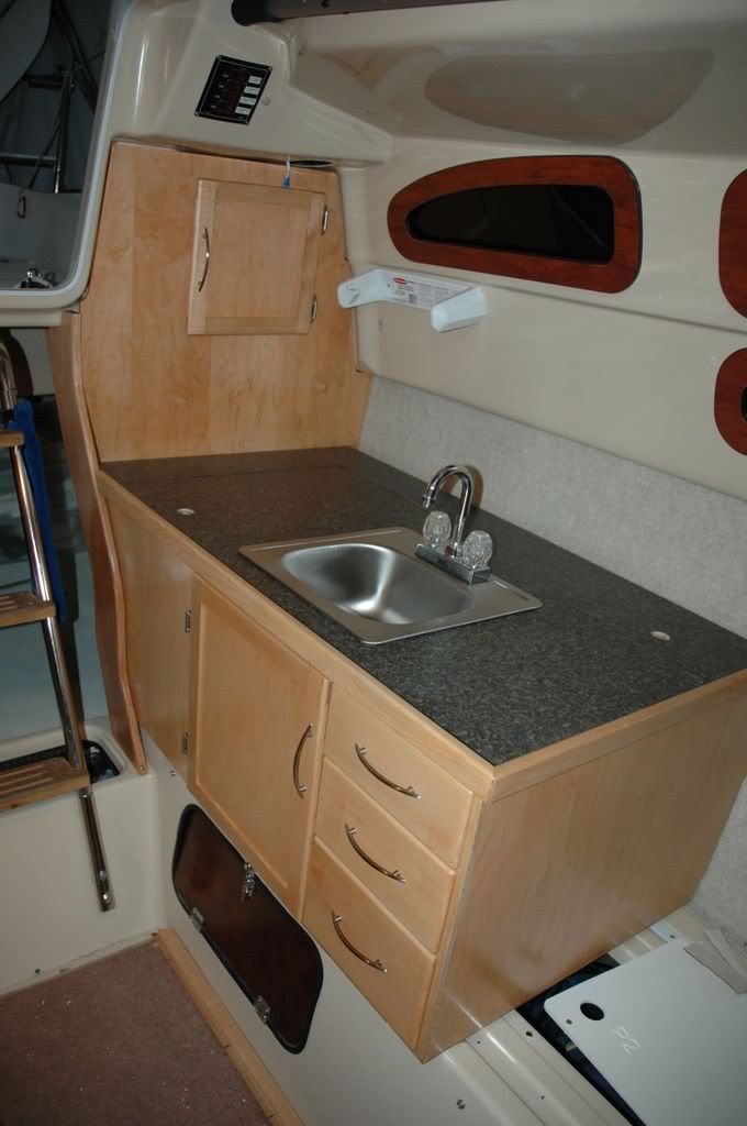

Great stuff Hvolkhart!! Love the galley. Does it still slide into the berth area? I think Jack Sparrow did that. I'm looking forward to seeing your ladder implementation. Keep us posted.

Since we have not moved the original galley during our trips, it was decided to have the galley stationary. Also the galy needed to be more sturdy to provide more support for the freezer/fridge.
However i think it would be possible to have the Gally "movable" on the original rails.

Well, the “Boat modification season” is over. Now it’s time to do some sailing.
The stair mod has to be postponed till fall. So has the front berth.
The front berth will get also a bulk head with an opening for getting in. The plan is to attach curtains for more privacy.
So far we had her out and where testing the improved battery / freezer and we found that we have enough power to “survive” 2 days without recharging the battery.

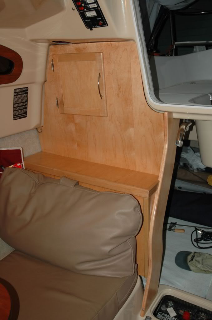

The two lockers on each side of the bulk heads turned out to be a very valuable space. The one above the galley is being used for storing dry food (tee, coffee, spices...).
The one above the shelf is being used to store all the safety gear (horn, ditch bag, first aid…).
The locker underneath the galley turned out to be the preferred spot for “fresh” foot since it is close to the water line and therefore fairly cool. I was gluing (silicone) a “floor” out of fiberglass sheet in that compartment so it is separated from the bilge.
An additional locker was installed above the mirrored seat. This locker contains paperwork as well as the laptop. The cover panel was cut so next to the locker opening there is still room for the stereo and the radio. Pix to follow.
