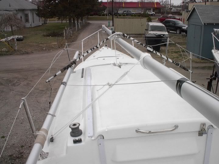

One thing that might be different. I was looking at pics of other masts and the spreaders look different. Mine are not designed to be straight. They have a bend where they attach to the mast mounting bracket. Both spreaders connect to one bracket in the front and then bend back. So replacement with stock pipe might not be an option unless I can find someone with a tube bender.
This isn't my boat, but the same mast and spreaders. See how they are bent where they attach to the mast.
Post by Frank C »
I didn't realize the M-spreaders aren't simply straight tubing.
(Sorry, X-itis fixation here!)
So ... that means it's prolly $35 instead of $10.
