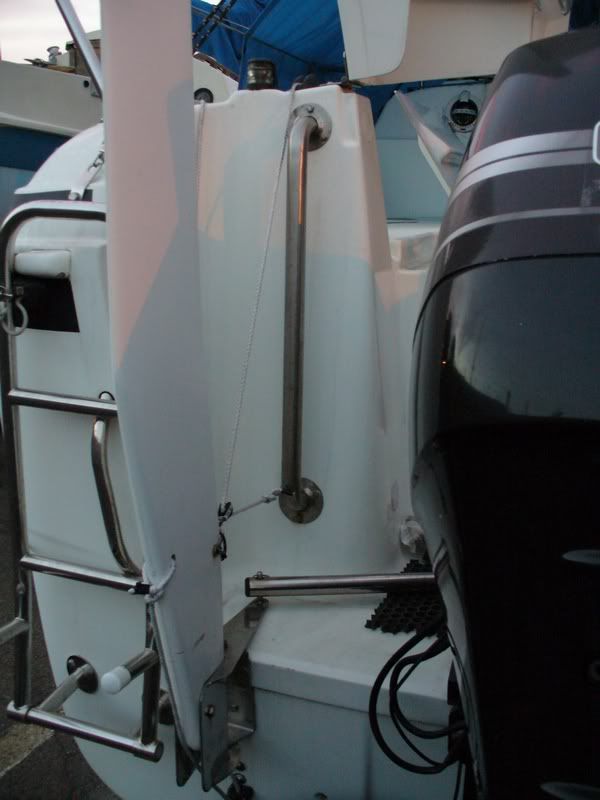

here's what i did.
used the standard MAC white plugs and slid a 1" wide x 1/8" thick stainless strip as a backing plate behind the handle, accessed thru the holes.
FYI...that's my previous Suzi 50 in the pic. have since upgraded to a Tohatsu 90.
Bob T.

Sorry for the late response, but I had trouble finding this picture.
The factory 26X already has an access hole right where the helm seat hinge was installed.
I just drilled another hole down low, easy access at the rear of the way-back.
This 24-inch SS handle, satin-finish, is from Home Depot's Shower & Bath aisle.
Unfortunately it's not made of the highest quality Stainless, but
a quick wipedown twice a year removes any light coating of rust.
The boarding ladder & its dedicated grab bar were installed by the MacDealer.
