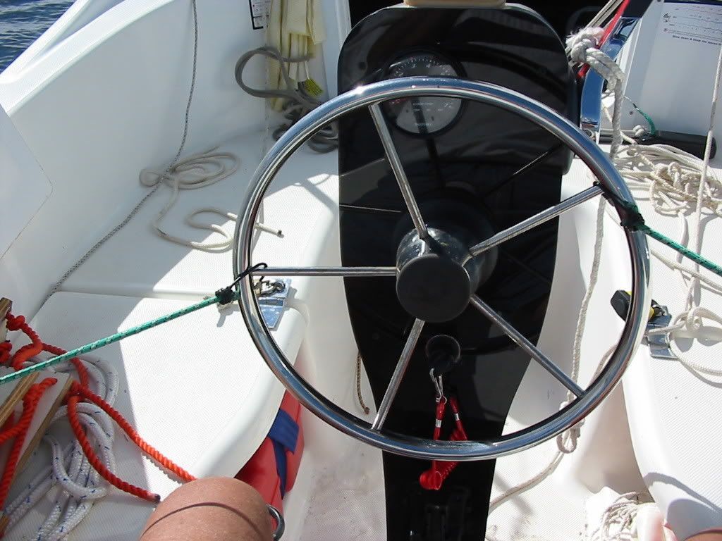

How about this for a poor man's autopilot....
Puggsy
Québec 1
Posts: 1447
Re: poor mans auto pilot
Post by Québec 1 »
puggsy wrote:How about this for a poor man's autopilot....
Puggsy
After seeing Puggsy's autopilot I resent :evil: the name given to my autopilot. It's called a wheel brake and It cost 50$ and poor men can't afford it......Right Puggsy! :D :D :D
