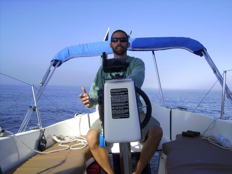

I have the cam cleat risers. Worked pretty good...although one did come loose on me. But after reading all the threads on Bill's EZ-Cleats I did buy them and I absolutely love them. Don't even use my winches anymore. Genoa sheet runs to the EZ-Cleat on the side of the cockpit and just ends there.
Here is a pic of JCasale (a member here) on my
. The EZ-Cleat is right on the left hand edge of the photo. The line ends there...no need for the winch. And I have sailed with full Genoa in about 15 Kts and had no problem controlling the Genoa this way.
