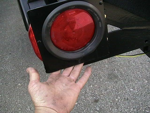

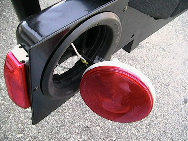

Cleaning the grounds got me back enough lights to get the motor recall taken care of. The bottom inch or so of the metal bracket holding the bulbs in place is quite corroded.
For any newbies, I verified this with a meter set on dc volts. Take out the big bulb. With the red lead placed on one of the contacts ( in the plug, of course) and the black on a clean, uncorroded ground, I got 10 volts or so. But moving the black to where the grounding bolt goes yields no voltage.
I wire brushed the hole, and scraped with a razor etc... This brought the left side from 0 to 100% functional. Unfortunately the right side screw is so corroded I will leave well enough alone and take her to the motor guy for the evinrude recall finally.

My OEM lights corroded after 3yrs of fresh water trailering and storing the boat indoors. I replace all my lights with LED lights. Zero maintenance and much brighter. Next is the wiring just incase it is as poor quality and the OEM lights. Also I'm going to use water proof shrinks at any of the joints.

I finally gave up fighting the factory lights a couple years ago. In general I found most often the problem really wasn't the light fixture it self, but in almost every case was the ground connection. I never has corrosion problems inside the fixtures even though I often launched in salt water. It was the corrosion on the trailer at the ground connection that was the issue.
For around $50 I switched to a set of sealed LED lights that came with a full wiring harness that completely eliminates using the trailer frame as a ground. I've not had a single trailer light problem since. Granted I don't have side lights now, but I really don't care, the old ones on the fender bracket rarely worked with the abuse they took in their exposed position. It's quite rare for us to tow at night, I really just wanted stop and turn lights, the reflectors can do the rest. I found one issue with this change, the backup solenoid for my disc brakes relied on the trailer ground to complete it's circuit. Don't forget to address this when you go to a fully wired solution.
