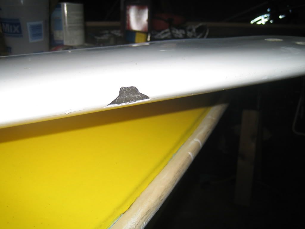

I had the shock of my (sailing) life when I checked my dagger board recently:
http://www.sailblogs.com/member/morwenn ... pid=101678
We had a gentle grounding onto a sloping sandy beach when approaching to anchor but it obviously wasn't as gentle as I had thought. This will be a definite check point for the future. Although the daggerboard does seem to be easily damaged it is (relatively) inexpensive and I would rather it crumpled than tearing the trunk out of the hull.

Wow! You wouldn't expect that on the trailing edge. Looks like a shark took a bite out of it.
From what I understand, the daggerboard trunk is surrounded (reinforced) by all that resin to create the permanent ballast so I doubt it could be damaged.
I've only grounded once in a soft bottom at a VERY low speed, but now I'm gonna go pull that thing and examine it.

I've never hit anything with my board and the very thin trailing edge had damage.
The bite was about 3.5-4" tall and about 1/2" deep.
Looked very much like a " ( " right at were the board exits the hull bottom.
I think it's due to the slop in the board versus the size of the trunk.
Underway, the board pivots somewhat as the extended section is forced aft while the top of the board is still in the trunk.
The thick leading edge up in the trunk is hard against the forward interior of the trunk and the thin aft edge is pressed against the aft hull opening.
The thin edge will break away easily until it becomes thick enough to spread this force over a larger board area, and the damage seems stop at that point/thickness.
At least that's my theory for a board never grounded.
I'm not convinced it needs "fixing", in that the damage is somewhat self-limiting, at least in my case and theory.
My boards damage only went 1/2" deep after over 2,500 nm under the hull. ( I keep a GPS log)
I can't imagine it being any weaker to speak of and the same for any performance hits.
I did put a small section of 1/2" PVC pipe cut lenghtwise to slip over the trailing edge/damage and screwed it in place.
Done mostly to stop the cluncking while on the hook, but it also spreads the forces in a more controlled fashion.
Do this work while floating so that the OD of the pipe can be checked at full drop for any friction hangups between the trunk and the PVC.
You might have to slightly shave to PVC O.D. to get the board to fully drop.
