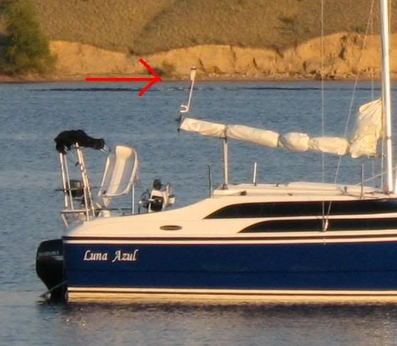

Yes. I used one like that. I replaced the bulb with an LED, although we got several nights out of 2 batteries with the standard tungsten bulb.Hardcrab wrote:Just offering another option for a less permanent anchor light.
A dinghy type, battery powered, LED portable stern light mounted on a 3/4" x 24" (or so) PVC pipe and run up using the main halyard, with a small trailing line to tie off tight to keep things straight and the light above the mast top.
(can offer details if wanted)
Simple, cheap, and effective if you don't anchor out all that much, or don't feel up to the routing of wires through the mast.
In a way, I prefer the anchor light closer to the water as fisherman are probably not looking way up high at my mast top.
