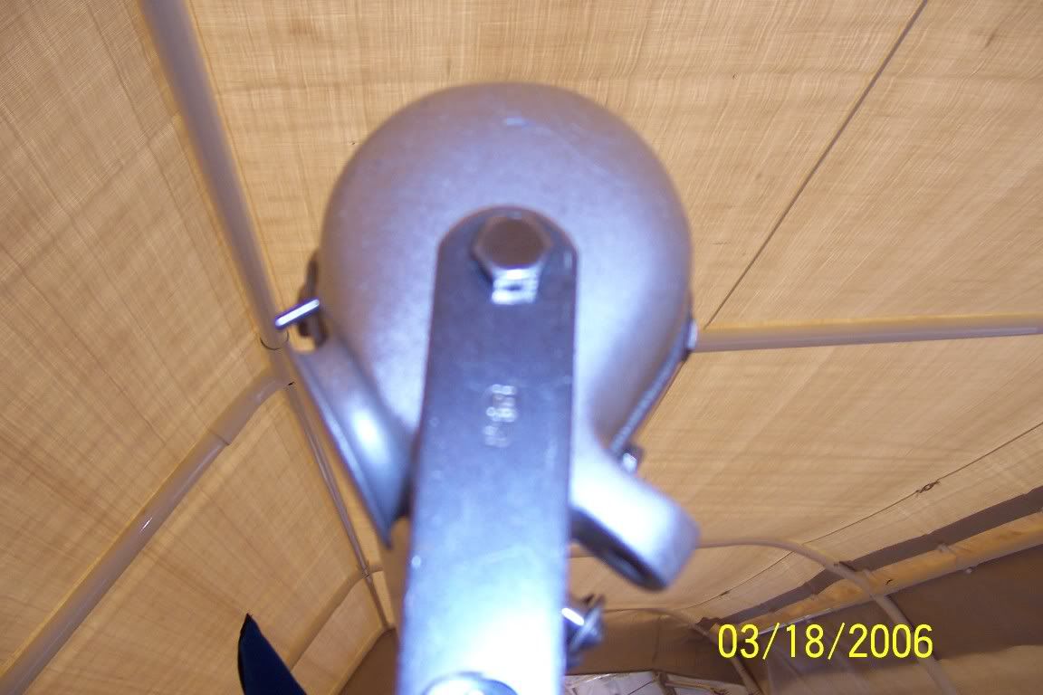

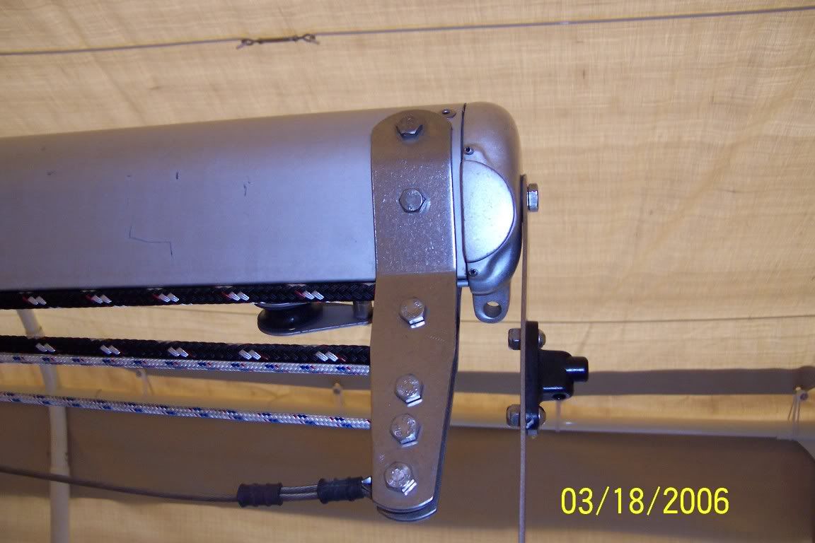

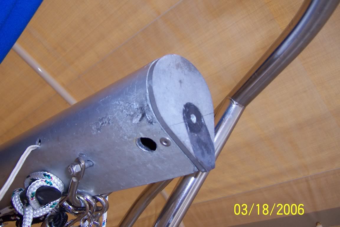

Re: Damaged Mast Foot 26S
Did it look like this?
Here's what I did. My 91' had a flat cap at the top of the mast. I straightened the bend and put the flat cap at the foot of the mast, giving it more strength, keeping it from bending again. Then I picked up a better cap for the top of the mast from Minnie's Surplus.
I posted this in the mods 26S section, under the heading "Mast cap & base".
That's exactly what it looked like. Very helpful - is this an immediate / emergency fix or can it wait to become a winter project?
Doug91mac26s
- Posts: 113
- Joined: Tue Jul 15, 2008 9:49 am
- Location: Oceanside, CA
Definitely not an emergency. That small amount of bend in the foot, won't cause any trouble, even if you tore the aluminum a little trying to straighten it out.
Does yours have a flat cap at the top? If so move it to the bottom, then you can contact Minnie's, http://www.minneysyachtsurplus.com/ You can show them a picture of the one I used, I think they will be able to identify the one I used, and they can ship it to you. Last time I was there a couple months ago they still had quite a few. I think the price is $17. I like it because it has a couple more attachment points, fits perfectly, and I think it looks better!
