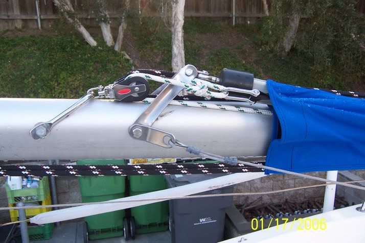

I have a CDI furler, with internal halyard, freeing up the original jib halyard. I use the unused halyard as insurance, attaching it to the bow pulpit where the base of the mast attaches while trailering. If the forestay lets loose that halyard connection will keep the mast from falling.
Also while trailering I make sure the furler is fastened securely to the mast, flat, with no unnecessary stress pulling to the side, I haven't had any trouble so far.

Re: Forestay Failure
That's exactly what I did. When I installed my new CDI FF2 with a 150 genoa, I had a new 5/32 forestay made with 5/32 hardware, with toggles. But keep it flat and secure bungee'd to the mast while trailered.
