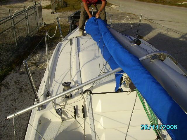

When I first bought my Mac the original owner showed me his technique for trailering which consisted of lowering the mast with the boom (main sail attached...slugs still in the track...cover on) still connected to the mast. As the mast came down you allowed the boom to hinge up but you had to "roll" it to one side to lay down beside the mast. Reefing lines and halyards were led back to the cockpit and they remained attached.
Then disconnect the mast from the base plate and pull the base of the mast forward to a point about halfway between the base plate and the bow pulpit. The mast would hang over the back about 6-8'. This was as far as we could pull it forward due to the length of the halyards led aft.
I trailered from Tampa, FL to Jacksonville FL this way...about 250 miles. Worked fine. And then for the first 3 months I kept the boat in a storage yard about 2/3 of a mile from the ramp and trailered it back and forth this way. Made raising and lowering much quicker.
However, before my first long trailering trip I started removing the boom and taking off the spreaders. I no longer do the old way. Now when I trailer I always remove the boom and spreaders (some folks don't remove spreaders).
Just another option to consider. Good luck.

[quote="c130king"]Another option to consider:
This seems well worth considering. It takes me (by myself) quite a while to remove & reattach boom, reef lines, lazy jacks, slugs, halyards, etc.
