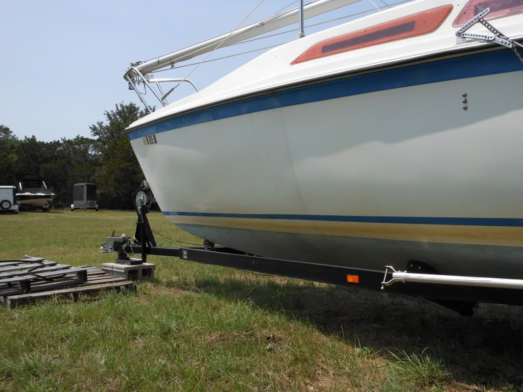

Finally got my 26D I've been hunting for. One problem is there is some staining on the sides like it had been sitting in the water for a while at one point. See the yellow waterline in the picture?
Would anyone have any suggestions on a proven way to clean it up without damaging the fiberglass gelcoat? The finish is pretty good so I want to protect it for as long as possible.
Initially I was thinking of using something like what is used on sink faucets (nylon Brillo pad etc.) but thought that might be too abrasive. Also worried about what chemicals to use. I know some can stain or damage further.
Any advice appreciated.

Good luck! I had similar looking crud after a river trip. I got it off with SoftScrub and lemon juice. It is not "very" abrasive and the acid in the lemon juice got the color off. It is non toxic and cheap, use a bunch.

Try this.
http://www.auroramarine.com/aurora/cata ... .php?cat=1
Haven't use it, but have used many if their other products. Loved them all :wink: They've always worked as advertised.

I saw a video on YouTube about oxalic acid. (Check that name) Wow. I have since got some but decided to slip my boat this year and practice sailing. I do plan to remove the bottom paint and clean the (rust or what ever that is?) off the hull before I reseal it.
Here is a link to youtube.
http://www.youtube.com/watch?v=IER1gzjLizM
