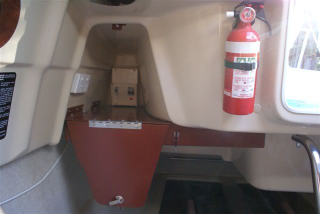

Also here is a photo of what we did with the stbd side rear section it shows a drop down door for the compartment housing the 240v swbd which is supplied by mains and inverter but the forward section is great for quickly needed items like sunglasses, windmeter, phones etc which can also be charged there as it also has 12 and 240 outlets, below (obscured) is a drop down door for computor, maps, etc etc.
The port side is similar but the top section is used to house the radios and volt/ammeters and behind that is junctions for mains cables from the batteries to the main switchboard and below is another drop down door unfortunately I can't find a photo?

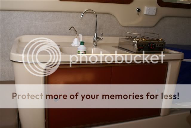

this is a photo of the galley front which I installed sliding doors to give unlimited access to the space unlike the factory one whic is very limited, all this is done in aluminium sheet and powder coated.
One of the things I like about our macs is that they are a blank canvas to change for our personal req.

Boblee, we like these shelves. I'm curious, how did you install the brackets? Just a lot of very short screws? Some sort of screw-rivet or ram nut if the space between inner/outer hull sufficient? Or, did you go all the way through the hull? Thanks!Boblee wrote:Also here is a photo of what we did with the stbd side rear section it shows a drop down door for the compartment housing the 240v swbd which is supplied by mains and inverter but the forward section is great for quickly needed items like sunglasses, windmeter, phones etc which can also be charged there as it also has 12 and 240 outlets, below (obscured) is a drop down door for computor, maps, etc etc.

Basically self tappers and sikaflex, the/any pressure is downwards and if they are tight shouldn't move and haven't after many many thousands of miles on land (rough) and water, did have a problem with the portside upper braket (radios, ammeter and voltmeter) as I didn't fit it as well due to not as much weight but made the bracket and the fibreglass a better match and no worries now.
Been there for nearly seven years, it's all made out of aluminium sheet, bent and welded then powder coated, note you could probably use large pop rivets to secure but the pieces would need to be a really tight fit.
