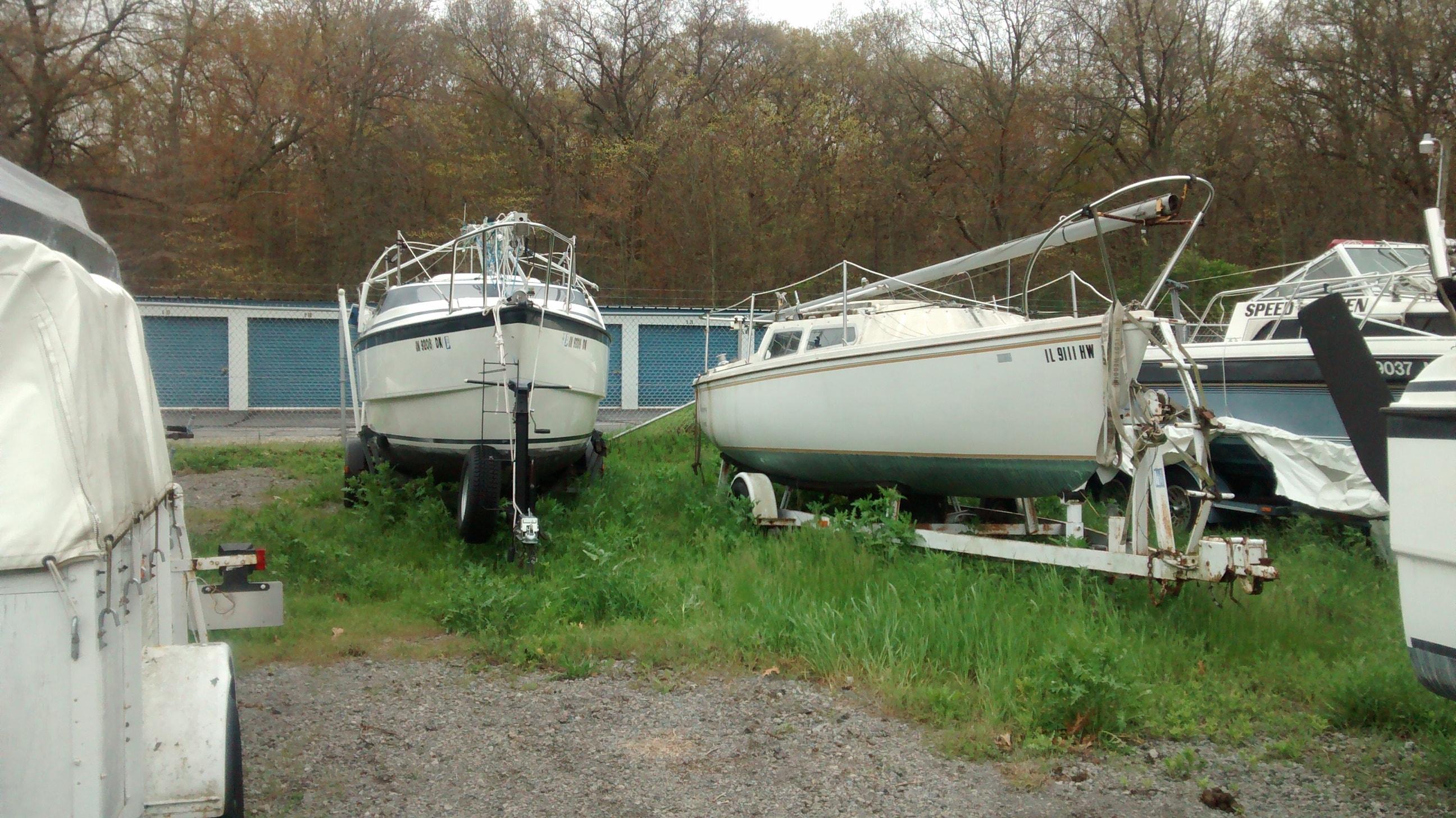

So my 2000 :macx: has to my best knowledge sat for a minimum of 5 years unattended. I finally got the the interior cleaned out for the most part now I need to turn to the outside. I was rinsing her off and I realized truly how chalky and oxidized she is. I have searched to forums here and other general boat repair sites for what exactly I need to do to get her shine back. I am not sure if I need to wet sand or if marine rubbing compound applied using a buffer and then a few layers of wax would work or if anyone can suggest a better method.

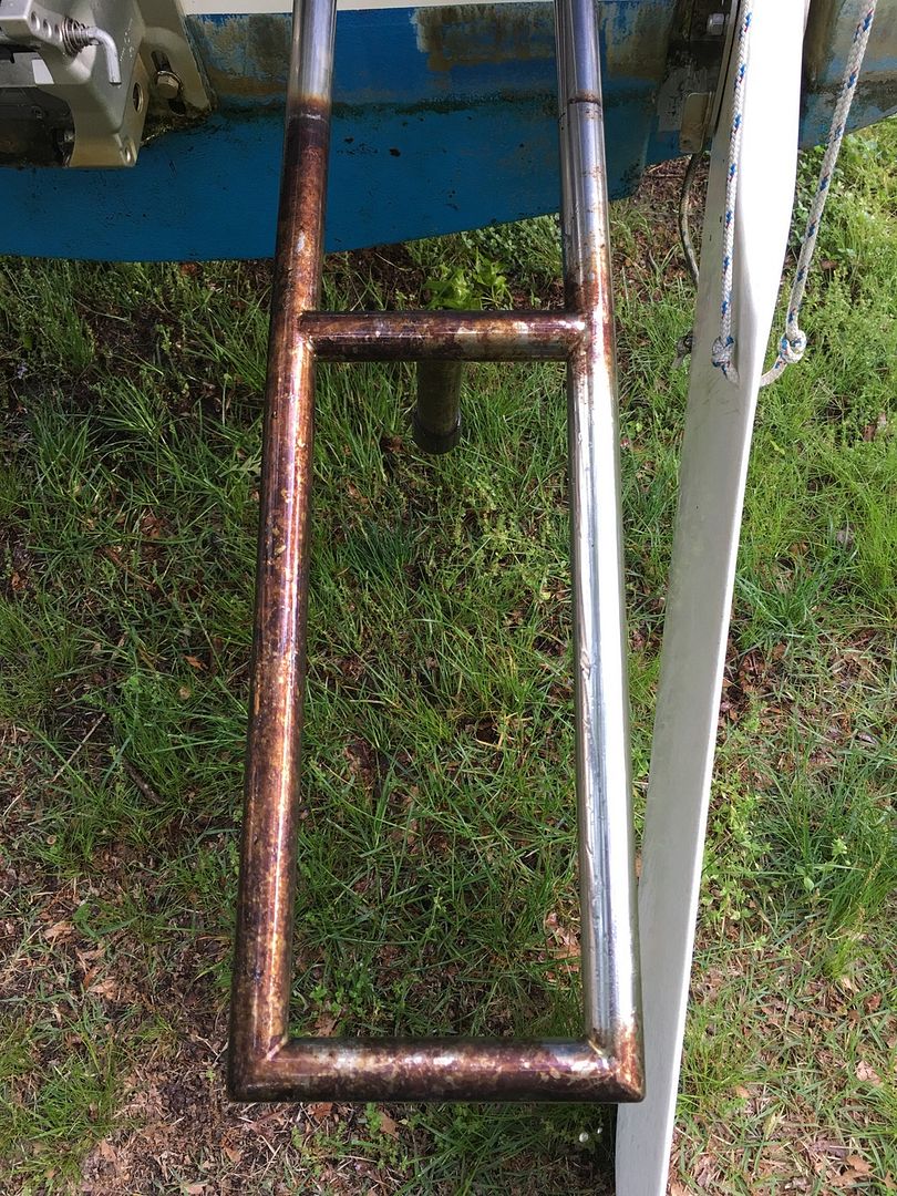

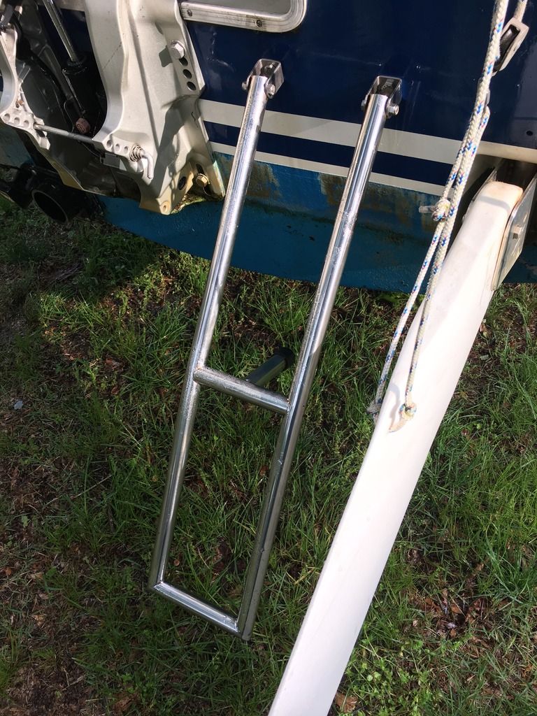

The Barkeepers Friend worked great on my swim ladder which decided to take a little swim over the winter months.
I look forward to using it to try to and clean up the hull this weekend if it ever stops raining.

But looking at the swim ladder I ask if it was made out of the correct material.
If you take the correct ss steel it should not corrode so much... right???

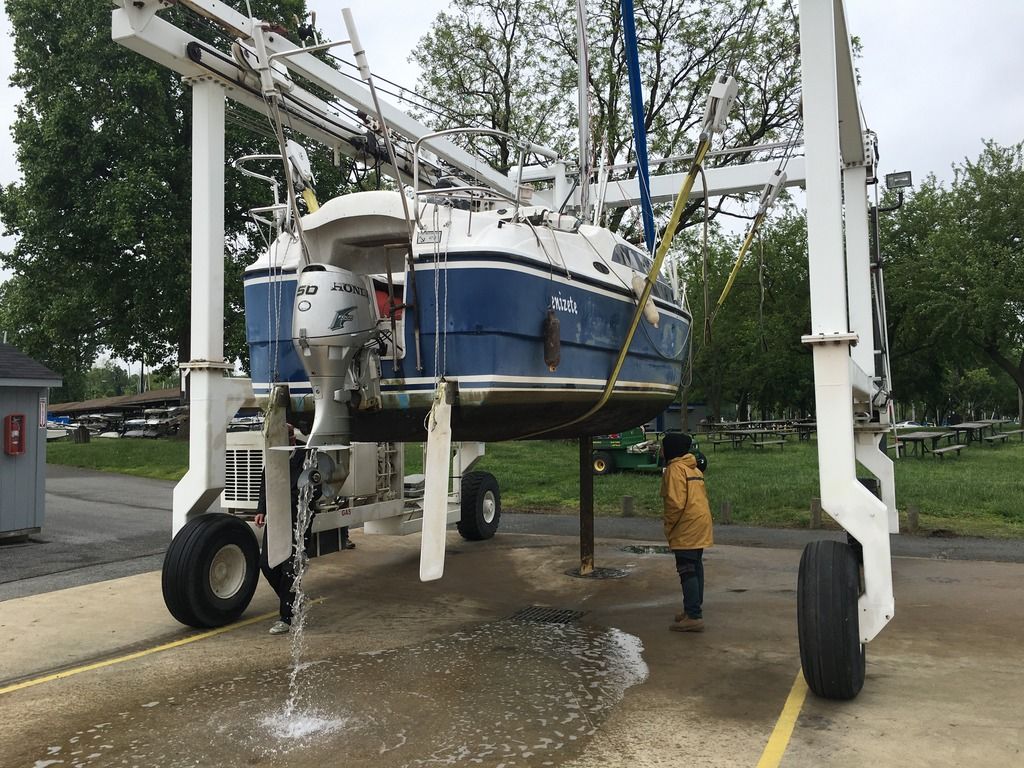

It wasn't corroded, it was covered by the same growth that was on the bottom. Although the power washer cleaned the bottom nicely, it had hardly any affect on the ladder.
