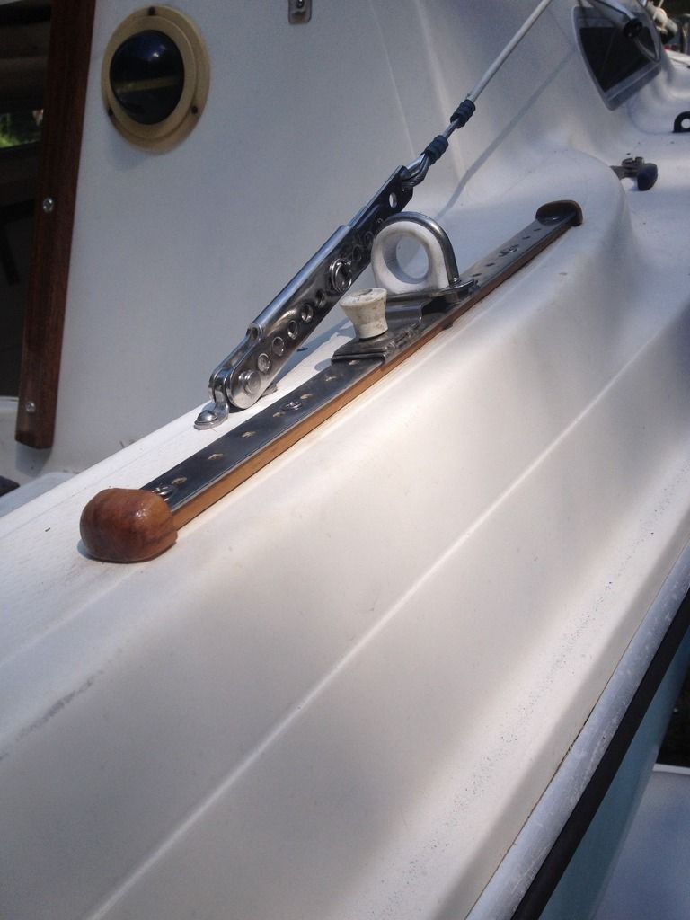

JohnCT wrote:The trick to getting good adhesion is sand to good clean solid wood, wash liberally with acetone to remove the surface oils, then apply multiple light, even coats of new varnish with a quality brush
Depending on how bored you are, multiple coats can be 5 or 50 depending on the look you want.

JohnCT wrote:Needed to rebed the genoa car tracks and the plastic spacer and stops were not usable.
I had some teak laying around
Hi JohnCT, Assuming the "CT" indicates Connecticut?
Living in the SF Bay Area and I am looking to do something very simular, but I cannot find anyplace to buy Teak trim. Did you cut it out of a larger sheet or can you advise where you get it.
Nice job.
Mike L.
Home Depot has Teak Strips in the exact dimensions - I'm in Davis, CA
I'll check into this.
M.
