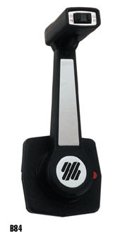

I am curious. I just had my Suzuki engine installed. My dealer put on Ultraflex controls. These controls don't have the engine warm-up lever. The dealer, of course, said I didn't need it with the electronic fuel injection. These controls seem a little cheap. The up-down arrows fell off the first time out. When I asked the dealer why he had installed these, he said the Suzuki controls didn't fit and the Ultraflex controls had a better warranty anyway.
Questions:
:arrow: Do the Suzuki standard controls fit on the Mac 26X?
:arrow: Is the warm-up lever needed?
:arrow: Does anyone use the warm-up lever with these engines?

I think that you may have the warm up controls on your boat but not know it. Try pulling the throttle lever out from the base and then rotate it to a higher throttle setting. I hope that helps. Happy sails, Tony

He recommended using Suzuki's "deluxe" control, not the standard or after-mkt control - extra $200, includes warm-up, fits fine, works fine.
Yes, I use the warm-up lever while idling at the dock, probably not necessary with EFI.
You're correct - thanks! I'll have to give it a try. I wish the dealer had told me that. I specifically asked about it.
From the web page - Pull-out handle disengages shift for warm-up:
B183 - B185 - B184
Single lever / dual action control to operate both throttle and shift.
Suitable for any type of boats with outboard, inboard or I/O power plants.
FEATURES
Enables easy and safe shifting by preventing accidental gear engagement unless engine is idling
Can be installed horizontally or vertically, on the starboard or port side of the boat
The lever assembly is made of painted marine aluminum
Provided with a brake tension release system adjustable from outside
Neutral safety switch X12 - 34543 Q (optional) prevents in-gear starting
All models are provided with positive lock-in neutral to prevent accidental gear engagement
B84 model is provided with a power trim switch conveniently located in the handle grip that enables for
easy tilting of the engine
For use with all Ultraflex engine control cables except C22 or C4.
Ultraflex C5 and C16 cables require K35 - 34730 U
connection kit

I would consider that control an upgrade. It makes a much cleaner installation that the usual outboard box bolted to the side of the pedestal.
