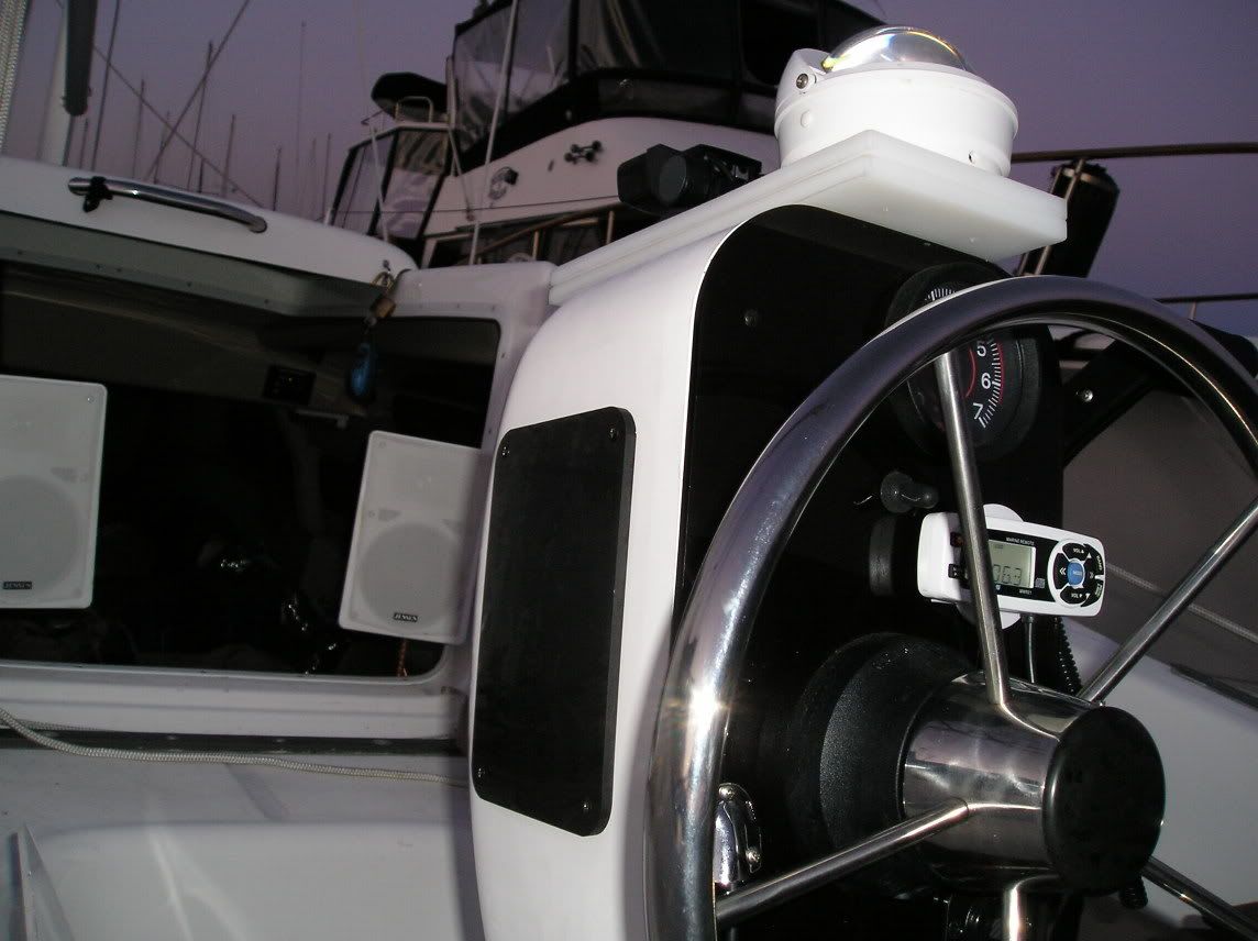

My interest in the new pedestal demands we ask if the engine controller is a new Uniflex and I like what appears to be a different wheel hub. The Black Face of the helm makes the wheel stand out and the installations really stand outI wonder if the base mounting brackets might benefit from mounting the angle bracket inside, or something like the X helm. The new helm is a major change and has great potential.
Latest M Pedestal with new wheel hub and new engine control.
Early M pedestal with Uniflex engine control.

Those of you who have the new '06 binnacle. How do you gain access? does the whole black panel come of including the steering wheel? How does that work? It does look like you can add controls without the binding occuring like it does on the 03-5 models.
ssichler
Posts: 342
Joined: Thu May 04, 2006 9:22 am
Location: Redondo Beach, CA 06 M 60hp E-Tec
Re: access to wiring?
Post by ssichler »
Richard O'Brien wrote:Those of you who have the new '06 binnacle. How do you gain access? does the whole black panel come of including the steering wheel? How does that work? It does look like you can add controls without the binding occuring like it does on the 03-5 models.
There are three plexiglass panels held on by screws.
David Mellon
Posts: 507
Post by David Mellon »
Mine has a single removable panel on the port side held in place with four screws.
The front panel is mostly backed by plywood. I found it best to drill an oversize hole in the lexan plastic and set screws into the ply. The lexan tends to crack.
