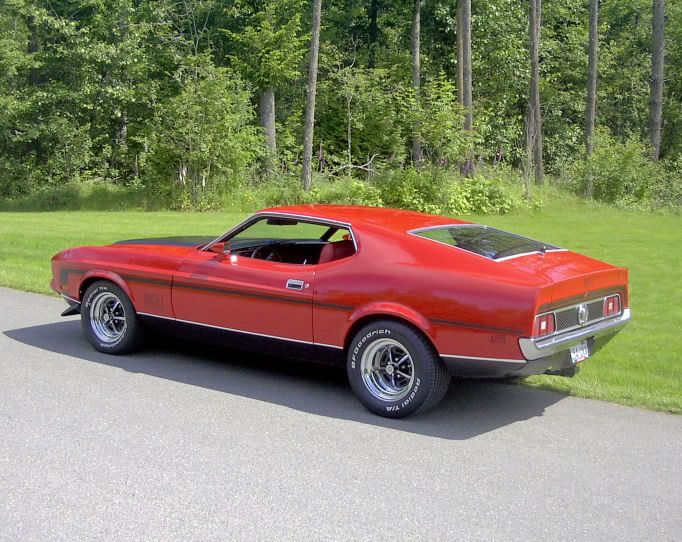

I have a classic mustang and I have a trailer hitch on the back but I would not consider towing the boat with it. The hitch is just for a light eight foot utility trailer.
I finished my car last spring. It is a 71 Mach 1 Mustang, with 460 cubic inch engine and toplloader four speed. It has, subframe connectors, 15 X 10 magnum 500's, a Holly 750, headers and flowmasters that rattle windows and set off car alarms. A real beast!

Very NICE piece of vintage road iron, Rich! I'll bet that trailer gets a nice ride! :D

Is that a Ford engine? I didn't know they made anything larger than the 428 Cobra-Jet and the 429 BOSS. I rode in a friend's Mustang with a 428 in it. Good grief did that thing jump when he popped the clutch. Unreal acceleration. My 289 was fast, but nothing compared to that beast.

I never heard of a 460 either. In 1967 just before I got married (for the first time) I bought a new Mustang convertible with a 390 that I had bored and stroked - - - 4 speed with a hurst shifter. Couldn't keep the car on the road - - - it was always in the shop - - - too much engine for the frame. That Ford dealer sponsered me to race it at Lancaster Speedway in Western NY - - - and they tuned it every week. That car REALLY jumped off the line - - - if one was in the back seat (what there was of one) their head would go right through the roof at takeoff AND again into second gear. Ah to be a kid again (or is THAT what I'm doing now) :?: :evil: .

I replaced the original 351 Cleveland because it was essentially a race engine (11.7 to 1 compression) that needed 100 octane leaded fuel. The new engine is a 460 CI Ford big block out of a 73 Lincoln, bored .030 over with a Comp 268h cam shaft. It runs OK on unleaded regular. I added frame stiffeners, heavier rear springs and traction bars to the car. The new engine is about 150 pounds heaver than the original one. Fuel milage is 8 mpg on a good day, if I keep my foot out of it.
