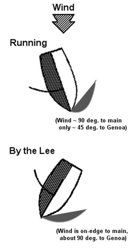

You can do it without a pole, but you need good precision in keeping your course steady once you get it. I believe you need to be about 20 degrees off of DDW and you put the main on the upwind side and the genoa on the downwind side. You can't let the course deviate more than about 10 degrees on either side and of course, the wind needs to remain constant. I guess if I was gonna do a long run like that, I would rig up a preventer. You can also use a spinnaker instead of the genoa.
It is not as efficient but less stressful if you run the main downwind and the genny upwind..the accidental gybe of the main is the main danger and you can minimise this in the less efficient configuration of main downwind.
I have run the :macx: pretty decently dead down wind , until I went to a beam reach and forgot about sailing in apparent wind and rounded up.

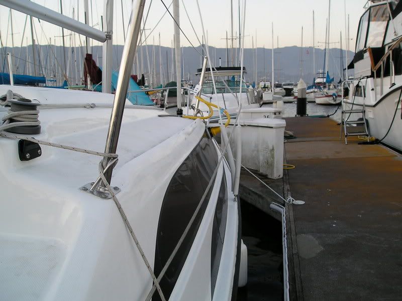

These are the shroud covers on The Yam. This is an easy install and the parts are readily available. The only downside is that you can't easily inspect the fittings.

Dimitri-2000X-Tampa wrote: ... you need to be about 20 degrees off of DDW and you put the main on the upwind side and the genoa on the downwind side. You can't let the course deviate more than about 10 degrees on either side and of course ...
Dimitri referred earlier to sailing-by-the-lee. He's right, in any sort of chop or swell, it definitely demands a preventer.
Discussed in a long thread, here.
When I first got my 26X, my dealer helped with first mast raising or two. He suggested suspending both verniers upwards with a bungee over the lifeline. After awhile, you just learn to watch them carefully - automatic.
Sailing by the Lee: causes the wind to fill the main from an extremely narrow angle,
but also enables wind to completely fill the Genoa, from almost 90 degrees-direct.

Here's a link to the WM listing for the covers
http://www.westmarine.com/webapp/wcs/st ... 65/11208/2
I use them on my boat to avoid the problem you had,as well as preventing wear on the genoa sheets

I was having trouble with stay eyes twisting at the adjusters when raising the mast. I bought 1 1/2" inside diameter clear plastic tubing and installed 14" pieces over each adjuster. That made mast raising easier, and keeps the adjusters straight while trailering. Cheap, also, and provides easy access to the adjusters for inspection or adjustment.

Not being flip, but practical. I just hacked some foot-long sections of 3/4" PVC pipe, and slipped them on the shrouds - no caps at all. It not only saves $35 on those prices, but it also avoids another trip to We$t Marine.
